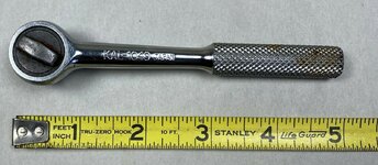

That ratchet is not SK made. It looks like a Thorsen. SK would have a different spring holding it in, you would need a pair of needlenose to compress it for release.
16,663
Mintgrun’s ratchet is not S-K, as bmwrd0 says. I would need a larger and clearer picture of your set but at first glance I didn‘t think S-K although I’m not sure about the ratchet.

Thank you for the information/clarification. I have an SK ratchet for comparison, along with a Thorsen, KAL and the JS.
EDIT: I am impressed by how smooth the ratcheting action is on the SK, but was disappointed by how loosely the sockets fit it; so I measured the plug, as well as the others. From left to right in the photo above,
KAL = .248" / S-K = .244" / Thorsen = .248" / JS = .246"

Maybe a larger picture specifically of the ratchet but it looks like four.cycle nailed it. Probably made by Pro America that used to be Kal Tools. A few years back I found an ignition wrench set with US military markings on the roll with Kal Japan tools in it. Here are some eBay images.

^ That whole KAL/Proamerica thing remains somewhat a mystery on its own. Toss in JS Technology and you'll be scratching your head for sure.
I have at least three ProAmerica 1/4" drive sets, and (unless I'm mistaken) a couple KAL branded sets as well. The contents are identical - they were packaged as a "small arms repair kit" with an NSN number on them.
If I had to put money on it, I'd say Proamerica was OE for JS on SOME items. (NOT all.) I know for sure they're OE on Jensen (per a phone conversation with Jensen a few years ago) on the 1/4" drive socket sets, and OE for Proto and Tekton on some models of pliers. Those I've spoken with on the phone at ProAmerica were unfortunately a bit reticent about divulging who their other contract accounts were.
(And KAL produced in Japan is of course going to be a bit different than domestically produced KAL.)
(And in an attempt to clarify: KAL is still a viable entity on its own, unless I've been misinformed. 100% of KAL's production is contract stuff for military/government. Proamerica (KAL's "sister" company) is the brand sold to the public, but (from what I understand) most of their production is done for private-label contract accounts (Proto, Tekton, Jensen, etc.)
