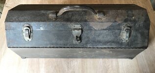

I'm posting some pictures of the "cantilivered" SK Tool Box along with a photo of some of the older tools that were inside. Some older Utica tools, a Snap-On, couple small Barcalo wrenches, Xcelite pieces, some Stanley, etc. The finish on the box is a dark green, but unlike the wrinkle paint SK green box I posted a few days ago, this is orange peel. It is 19" long. Can anyone take a stab at the date of this box?
