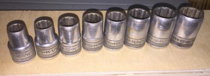

The 1/2" drive S-K socket set seems close to complete. Not that I would know though. I suspect the ratchet may be later (newer) than the rest of the set. It is the only piece that is marked "S-K Wayne". Part# 42470. There is a 5" ext (40161), 10" ext (40162), speeder handle (40181) and 17" breaker bar (41653), All of these are marked "S-K" within a diamond-shaped box. There is a 10" sliding T-handle just marked "S-K" (40152). It has the following 12-pt sockets (all marked with just "S-K" no diamond):
1" (40132), 15/16" (40130), 7/8" (40128), 13/16" (40126), 25/32" (40125),
3/4" (40124), 11/16" (40122), 5/8" (40120), 19/32" (40119), 9/16" (40118, 6-pt socket), 1/2" (40116) & 7/16" (40114). There is one deep socket 13/16" (40826).

That 4218 set looks like it contains just about everything I've got. Clearly, I've got the 19/32 & 25/32 sockets which aren't part of that set but I'm missing 1-1/16 and 1-1/8. Would you say the S-K Wayne ratchet is newer and not part of that set? Also, the speeder handle is bent. What would be a safe way to straighten it out? I'll post a pic tomorrow of the bend. I also recall seeing a cross bar in that toolbox. I had no idea what it was or what it went to. Might it be for the 17" breaker bar? I'll have to check tomorrow to see if it's marked. Were the S-K cross bars marked?

The 4347 set at the bottom of the page I posted shows the crossbar. It kind of looks like a bar for the sliding Tee only it fits the 17" flex handle. That set also contains your 19/32" and 25/32" sockets and your 1/4" drive set. It shouldn't be too hard to find your missing sockets. The S-K Wayne ratchet is definitely more recent than the rest of your tools showing up first in '64 after the '62 Wayne acquisition. Hope that helps.
That's so cool that I already have one full set (the small 1/4") and another almost filled out!!! What I thought might be the cross bar wasn't. Didn't even come close to looking like what was in the catalog. So I need the S-K box which I figure is likely going to be the hardest piece to find. The correct period ratchet, the cross bar and three 12-pt sockets - 1-1/8, 1-1/16 & 9/16. Need to get that speeder handle straightened. Here's pic of the bend.
Also, a pic of that piece I thought might be the cross bar. Anyone know what it is? No markings on it that I can find. It's got a knurled handled and two small nibs standing proud at the other end. It measures a hair under 5/8" (.624) diameter.
Just went to verify my 1/2" drive sockets were indeed 12-pt and looking at that lone 6-pt socket started wondering if that 4347 set came with 12-pt or 6-pt sockets standard? The 9/16" socket is the only 6-pt socket in my almost set but the part number is right in sequence with the other 12-pt sockets. That seems weird. Am I looking for a 9/16" 12-pt socket to replace that 9/16" 6-pt? I'm confused.
