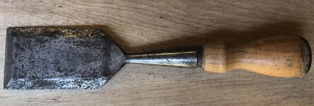

Didn’t see an existing thread for this.
Picked up this Witherby 2” chisel today at Habitat Restore for $3. Needs a new handle, and there is a chip in the edge. They started making chisels in 1827 and sold the company about 1869, but the new company continued to mark them Witherby. You can sometimes narrow down the age by the details of the logo, but mine is so faint that it’s not clear.
Question. Whats the best way to grind out the chip?

When I get a wood chisel that needs the blade squared away, I use my vertical belt sander and take my time removing metal trying to duplicate the original angle. It can be time consuming to remove the metal with that big of a chip.IMG_4233.jpeg

13,259
As Don says, Very Slowly.
Something that big is a little easier than a skinny one. But grind a little, dunk a lot, grind a little, lather rinse repeat. A coarse stone, or coarse belt sander, or coarse belt grinder. Short time w reasonable pressure.
If you burn the edge and lose the temper, you will have to grind more, else it won't hold an edge.
Some people like to blunt the edge back to the chip, to reduce the amount of thin metal you are grinding, reducing the odds of overheating.
