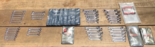

The wrenches do look very similar although my Craftsman set is in a bag rather the the nice roll that the Wright wrenches came in. The Wright wrenches have two sizes per wrench, unlike the Craftsman IMG_3944.jpeg

I did some more comparisons with the new Wright small combo wrenches and more Craftsman wrenches that I had on hand. I found some Craftsman wrenches with the same two size layout as the Wright wrenches. I’m not certain who made both brands but I would say that it was the same manufacturer.
Don
Wright and Craftsman Crown wrenches withe two sizes on each wrench. IMG_3966.jpeg

I remember reading somewhere that Apex made some tiny wrenches for Wright. Maybe a connection there.
16,602
Interestingly, the wrenches in the Wright roll have no Wright markings so them being made by another manufacturer makes sense.
