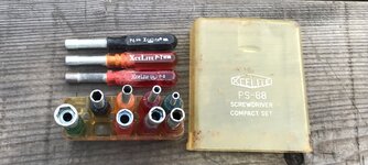

Found the single oldest Xcelite in my collection.
