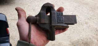

Athol 701. Ratchet Handle clamp-on. 1-5/8 jaws and weights 2-1/2 lbs. This one has the clamp broken.

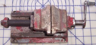

No Marked Mfg, but I feel certain "Bubba" had a hand in this?
Specs: 2-3/4 " jaws, 2-1/2 Fully opens "to the Stops" 10 Lbs: Fixed base.
It could probably do with some of that old Dr Scott Magic Elixir? :see:
Anyone got a spec sheet? I wonder what it cost "back in the day" :evil:

I guess it could go under the name of custom fab vises/Bubba. Looks like a challenge to restore back to good working condition. The vise handle reminds me of the older mill vises. Thanks for sharing.
