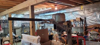

I was recently given this drill press for free I have managed to remove most of the stuck parts except for the quill, it is completely stuck inside the head of the drill press...
20240404_130847-jpg.2087243
What I'm wondering is if this bearing guide right here at the top of the head can be removed, that way I can have better access to the top of this quill

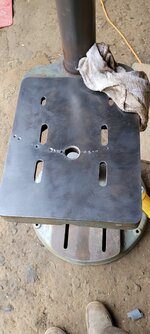

Okay I finally got the quill out after using a pipe wrench for the pair of vise grips clamped on the back and then a piece of pipe and it finally moved...
Here is the quill after it was cleaned

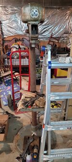

You might be a redneck if:
20240405_185154-jpg.2088008
I mean that in the best of ways/
I used a '70s Toyota scissors jack to get the head off of my DP:
Whatever works, bro!
