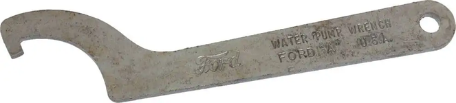

My 1930 Model A Ford, and all Model A's have a water pump with a packing nut. Behind the nut is a rope packing. The nut has to be tightened periodically to prevent it from leaking. The nut is not hexagon but rather a round cylender with groves in it so water pump pliers are the ideal tool to tighten the nut.
Yes, the picture that I posted shows a hex nut but I know that I've seen a different 'toothed' version that there was a special tool for - that nobody had. They look like this:
And the special wrench looks like this:
But, what works just the same and is much more useful over all are these:
