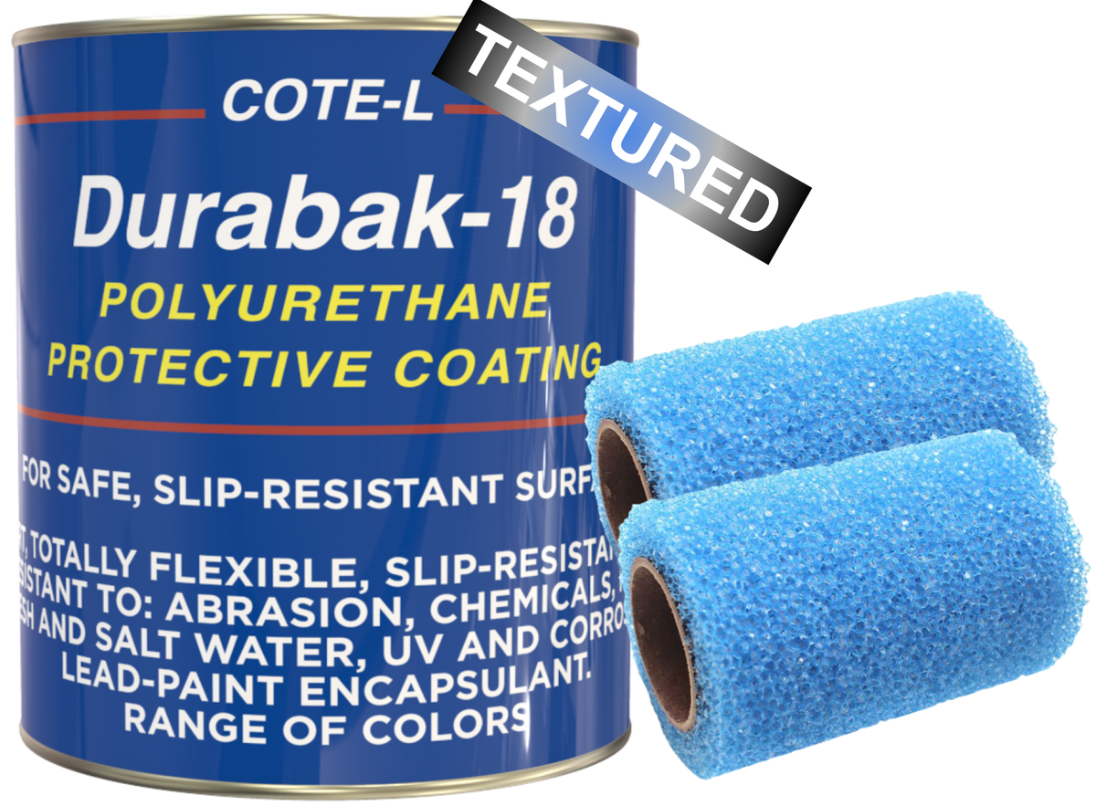

How about using a roll on bed liner material, I just used some durabak & it seems indestructible. Durabak is a little pricey but there are cheaper ones & this stuff will cover joints & corners nicely.
