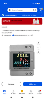

For 240 V equipment, there doesn't appear to be much ready-made, plug-in devices, like there is for 120 V.
I use this on my repair bench to just monitor current and power draw when I'm working on something; it will handle 240 V at up to 100 A.
You will have to mount it into something and wire it yourself. I put it inside a 4 x 4 Jbox with a blank panel custom cut out for the display and one-button control.
And yes, that one-button control is kind of hokey - to reset energy drawn, you have to pick up the instruction sheet every time.
A heat pump won't be plug in, anyway
That meter you linked would only be reading 120v...does it have a function to double the amperage so that it reflects the wattage correctly?
On my Emporia, you can tell it you are measuring a single leg on a 240v device and it will adjust accordingly.
I use a similar device to monitor the power usage of my level 2 charger for my electric car and it worked fine for me. It monitors the 240 circuit just fine.
The voltmeter can and should be reading the difference between H1 and H2, thus 240 V or thereabouts - there is no neutral on a 240 V heat pump circuit. And the toroid that feeds the ammeter function reads the current in either H1 or H2 - and it doesn't matter which one you pick because the heat pump is a balanced 240 V system.
Power and energy thus involve straight arithmetic, there's no doubling - V(RMS) * I(RMS) = Power (at unity power factor anyway, but this device does accommodate PF correction). And the integral of power over time is energy used.
I like the ammeters that use a regular 1/2" knockout to mount: https://www.amazon.com/dp/B0BG2LD82C?tag=atomicindus08-20
Agree, that's a nicer mounting system - but none of these three different models read anything beyond instantaneous voltage, current, and frequency. There's no power and integral of power to get energy, let alone power factor measurement and correction.
@WI/MI Border definitely needs the latter, so he can point to a single number on the readout and say "See - I told you so - it's very low cost." If he has to Man-splain heat pump duty cycle factors, AC power factors, integral calculus, and the like to her, we can predict how that will turn out now, yes?
