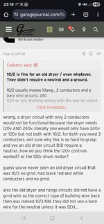

It didn't exist as far as the code goes. And I didn't come across a post where anyone claimed to have never seen it. I did see plenty of posts other than my own saying it wasn't correct.
Normal practice would mean that someone thought it was the right thing to do, and I believe this is the first time you've used the word hack.
Hack. That was auto correct or a fat thumb. I edited it i think.
It was supposed to be back
Eta. It was mentioned at least twice that 10/2 was not used and it was 10/3 w/o ground. Because no one would use a bare wire for a curre t carrying neutral.
I was somewhat called a liar in roundabout terms.

Every one of us that have been doing this job long enough have seen 10/2 used for a dryer so I doubt he was saying it literally didn't exist. He was saying it was supposed to be 10/3 and the old 10/3 (or 14/3, 12/3, 8/3, and probably 6/3) didn't have a ground and that would have been the proper cable to use. 10/2 w/ ground would have been for water heaters, air conditioners, ovens (not ranges) and some cook tops though I've seen all of the above wired with 10/3 w/o ground using the white for ground. Those guys probably carried one type of wire for everything.

Ok. 3 conductor no ground was probably the correct wire to use. I don't disagree with that at all.
However , I don't know but believe that back then the thought was ..
10/2 was cheaper,
And why insulate a neutral back to the panel thats buried in the wall, I'm tying the ground to the cabinet of a giant piece of steel (dryer or range case/cabinet) thats touched all the time.
And the neutral coming to the house from the pole and into the panel is a bare wire and not insulated.

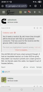

Maybe where your at they didn't IDK. But around here and other places it was 10/2 with grd. Sure the actual cord from the dryer was 3 conductors but the wiring in the wall was not.
Even on an old electric range most were hardwired with 2 conductors and a bare ground/ that served as the neutral also. No cord just straight from the wall to the range.
Thats NM. Someone used the wrong wire… doesnt even look like #10

wrong. if its not 120/240 then why does it need to use the ground conductor as a neutral? neutral is only needed for 120v and its not code permissible to send neutral current on a ground wire. anyone who says otherwise is a hack and creates potential for shock
a NEMA 10-30 receptacle (which is what is used for a dryer) is indeed 120/240 NO GRND.
dont believe me? look it up...
you are NOT i repeat NOT using the ground as a neutral. Its quite the opposite. you are using the neutral for the ground in addition to using it as a neutral....
THIS IS FACT. Period end of story...

whatever theyre wired with is not the point. They are 120/240 no grnd. go lookup nema 10-30.... Just because some hill-billy hack used the wrong NM wire doesnt make it correct and actually makes it potentially dangerous in some regards...
There was indeed NM w/ 3 insulated wires and no bare or insulated grnd back in the day. Ive literally seen it... it was probably a few pennies more per foot vs 10/2 with grnd so some penny pincher/penny-wise pound-foolish fool used it instead of the correct wire... still doesnt make it right just because you found it installed..... it was not code permissible and the applicable code is 250.140(B)(4)

More like 1% and all of them were wrong. The proper way would have been 10/3 and the old 10/3 didn't have a ground. Four wire added the bare ground to 10/3. I don't know when the manufacturers started adding the ground but it hit the code with the adoption of the 1996 NEC.
