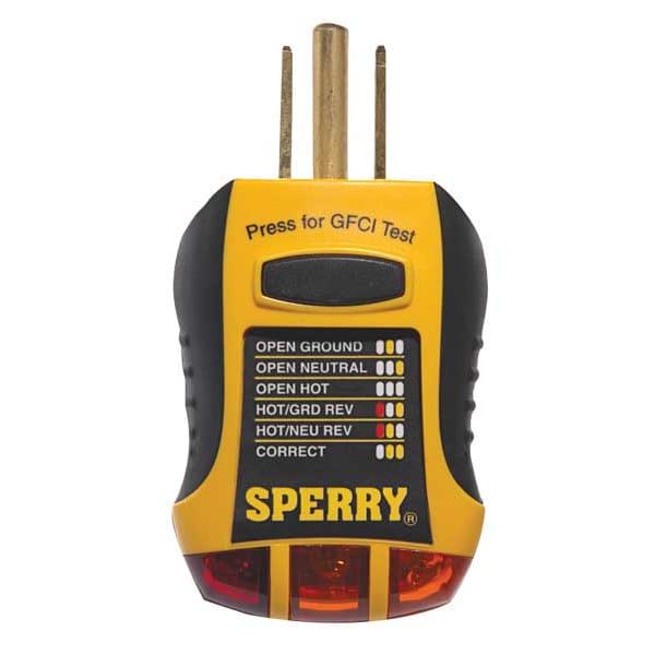

I carefully rigged up a temporary receptacle and plugged in my 3 light tester. I grounded the recep to the box. With the switch off, I showed hot/neutral rev.
With the switch on I showed hot/ground rev. So I got out my Wiggy and did more. Sure enough, neutral to ground lit up in "off" switch position and hot to ground in the "on" position.
