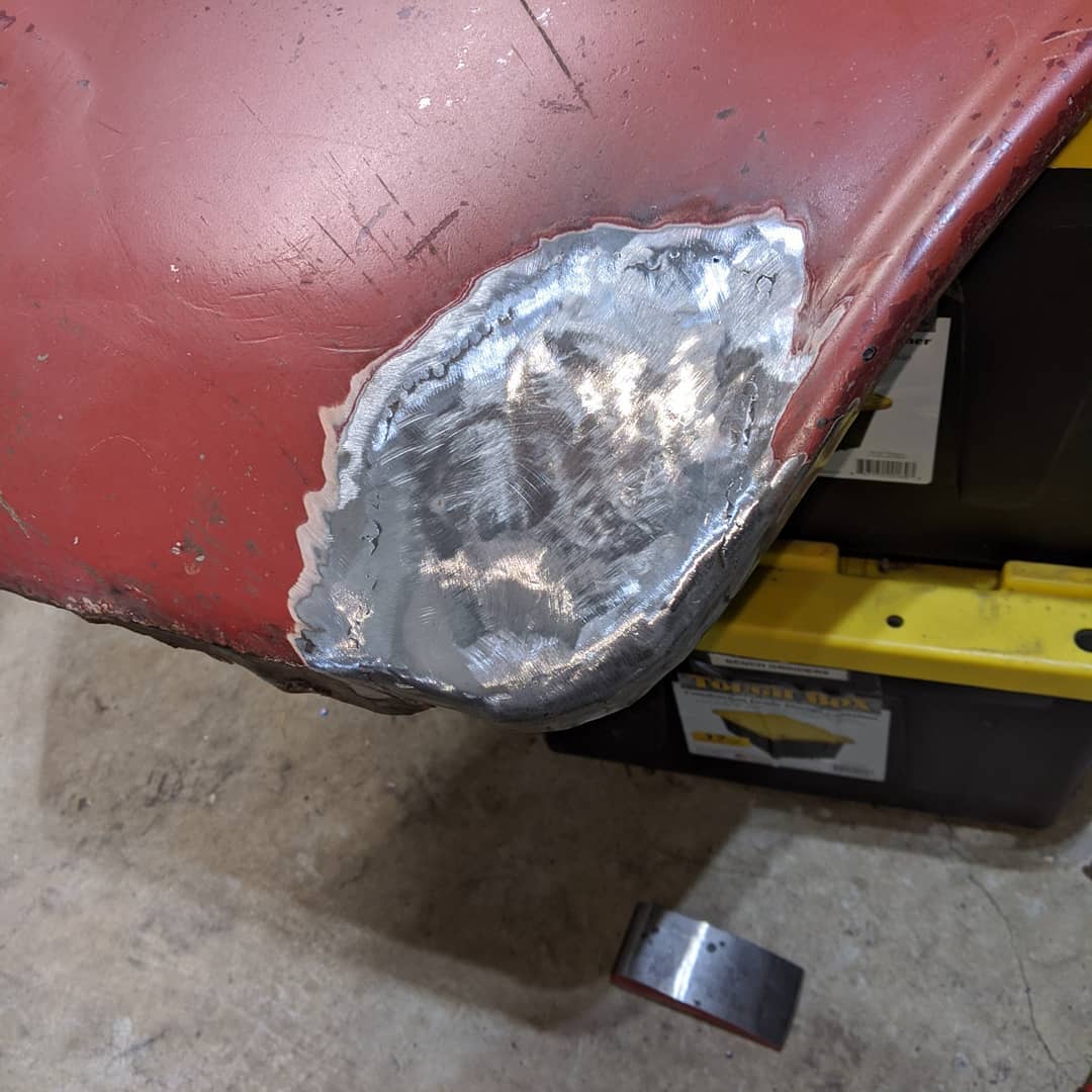

mannydantyla
Jan 24, 2019
160
LFK
keep this thread alive guys, this is a real gem

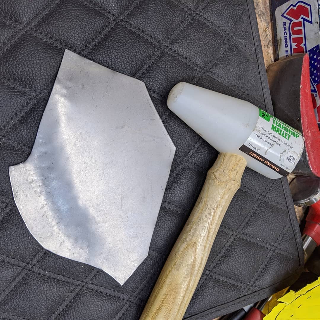

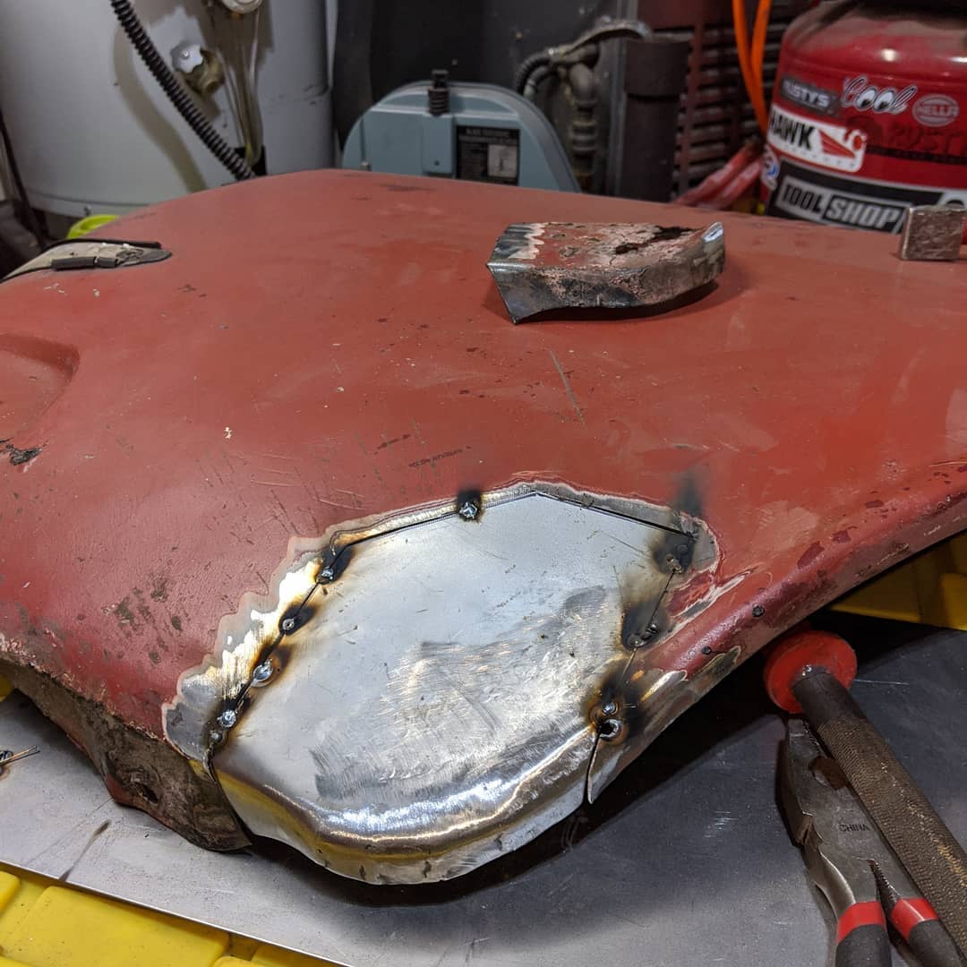

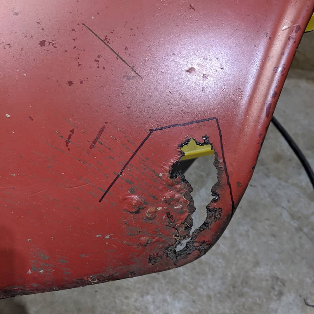

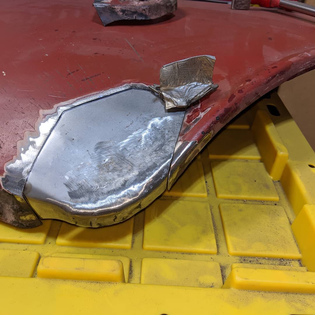

Here's another patch panel that I made myself and welded in yesterday. It took me about 4 hours probably!
A lot of the techniques I used are not preferred by the experts like Robert, but I did what I could with the tools I had on hand. I could have used a shrinking machine and a real shot bag, and more clamps. Always need more clamps!
Any advice is welcome, I'm not just trying to show off :D
Here's the damage:
After cutting it out, I wrapped the piece in masking tape, cleaned up the edges of the tape with a razor, peeled off the tape, flattened it and stuck it to my sheet metal stock. Traced around it with a sharpie, removed the tape, and cut out the metal along the sharpie line. It was the first time I've ever tried this technique and it worked out really well.
Then I got to work on shaping the piece to match the little curved fender flare. It's hard to get in the photos but there's curves and bends going in all directions.
I used a plastic mallet. And because I don't have a leather bag filled with lead shot, I used two layers of these floor mats with foam padding in them. Whatever works.

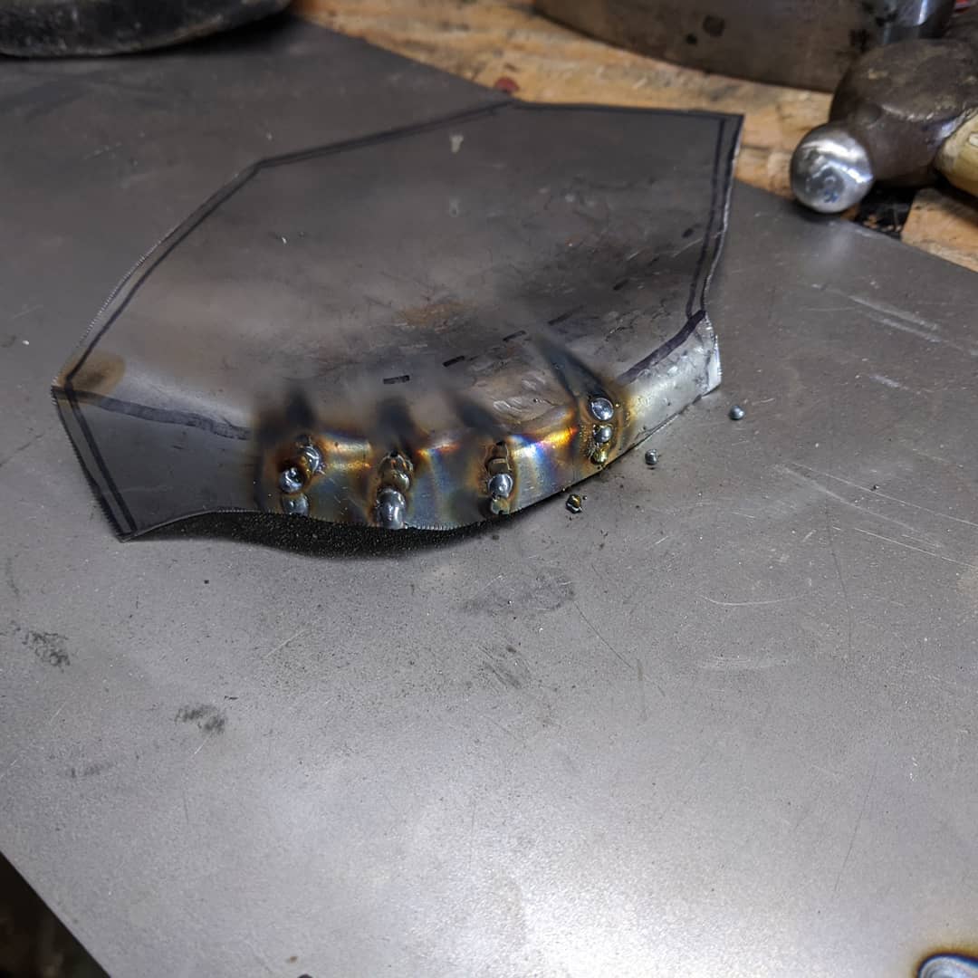

The inside corner needed some shrinkage. I don't have a shrinking machine, however I could have employed tuck shrinking and a torch - heat and beat - as Robert and others have suggested.
But instead I cheated and simply cut some slices, bent them down with some pliers, and welded it back together.
Then it just a matter of hammering, planishing (sp?), bending, shaping, and then finally trimming until it fit ̶p̶e̶r̶f̶e̶c̶t̶l̶y̶ good enough for me.
Started welding it in. It's all about trigger time. Not too much not too little. Yes there's a hole on the right, the metal was a little rusty on the other side I think.
There's room for improvement for sure but overall I'm proud of it.
Here's the car BTW:
It's not exactly a Concours D'elegance build :D IF I ever paint it, the patch panel(s) will need body filler, of course.
We all start somewhere, using the tools we have on hand. When I get done with each job I review the process and how it could be done better. Part of the learning process... and the formation of the want list for tools.. :bounce:
Good job getting rid of the rust!
