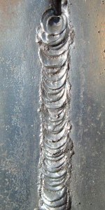

So I got good at laying a clean bead in a tight spot on material similar to (thinner) than the frame I need to fix with the 7014 rods. Boy, they were easy to strike the arc with.
Then, thanks to @dr_clyde , I went back to practicing with the 7018 rods and I can lay down a clean looking bead pretty reliably. My only problem is that I'm also (reliably :-/ ) getting these little pinholes at the start of my welds (rt side of pic below). Some are worse. I've tried to strike the arc ahead of the direction I'm heading and backing up before proceeding - didn't really work. Also, when I was practicing a bunch of starts and stops in hopes that I could improve, the restarts with the hot rod/surface were clean every time. But new, cold starts still have pinholes. Anybody got any suggestions to help me improve my striking an arc?

Porosity is always caused by lack of shielding. Pinholes are easy to get at the beginning of the weld with stick welding especially with beginners.
Here's my suggestions.
Light up with a fresh rod, or make sure your rod has flux all the way to the end. If it has flaked off or is missing chunks, it can affect your shielding cloud at the beginning of the weld.
Don't move while long arcing. It is common practice to long arc for a second or two until the arc is established and the rod is burning right. During this time, you don't have shielding. Wait a second or two tor the arc to stabilize, then get your arc nice and tight to get your puddle going. Don't move until you have a tight arc.
What settings are you running? If that was me, I'd be running a 3/32" rod at about 90 amps to start, then adjust from there.

Hey Doc! Thanks for the reply.
Good to know. Thx
Ok, I'll practice this for a while. Due to the thin material and small pieces, I've been afraid to hold still. Been starting the arc and move.
Yeah, I'm using 3/32 7018 at 75 amps. The thin material that I'm welding melts through really fast at 90a, but I'll burn a few sticks at 85 amps to see if I can control that. Don't have too many choices on the selector switch (see below). You also probably noticed that I'm welding pretty short tabs to the tubing that I'm practicing on. That's b/c it's similar to the little gussets I'll be welding to this frame. I've basically got to strike the arc and get moving. The welds will only be 1 - 1 1/2" long each and with pieces that small, I feel like I won't have much time before things overheat.
Oh yeah, I included some picks of the "cold" start-stops I was practicing. (waiting 10 sec or so between each stop and the next start. If I do these with a 1-2 sec delay, only the first start has the porosity

You could try warming up the electrodes a bit. 7018 absorb moisture when stored with the sleeve open. 130 - 140 F for an hour or two might help with the porosity. You probably don't have a rod oven so a toaster oven or regular oven would work.

Hello All, been out of town visiting family and finally got back to my "edjumacation" [emoji851]. OK to close the loop on what I've learned so far and the advice I've received here... (Remember, all of the following is using 3/32" rods at 75 amps);
1) Heating the 7018's had no impact.
2) long arcing at the start made the porosity worse.
3) stepping away for a week and coming back seems to have improved the quality of my starts, a lot.
4) since I was nearly out of Hobart 7018's, I got my hands on some Bohler 7018's and here's what my experience with the two rods has been side-by-side;
a. the Hobart 7018s are easier to start but continue to give me pinholes at the start of my welds
b. The Bohler 7018's are a PIA to start once used and are very difficult to restart without filing and tend to stick on me A LOT at the start. Really bad at 65 amps.
I'm going to try whipping the Bohler rods at the end of a weld to see if this makes them easier to restart.
Picture below is Hobart rods on the left and Bohler rods on the right. The first two starts for each were pretty ok (Bohler actually had a single pinhole). The third start on each was a small amt of long arching to try and make the pin holes come back - only the Hobarts got ugly. The last two on the Bohler (right) were extreme long arcs to try and force the porosity prob. but couldn't make it show up with those rods [emoji4].
Edit: when I originally posted this, I thought the new rods were Lincoln but we're actually Bohler. The label is pictured in post #66 below.

That machine should be on 85 for 3/32 lo hy. When I do welder training I usually only fool with flat a little and try to get to vertical as fast as I can.
I'm aware. The reason for practicing at the bottom of the rod's rating is so I can get good enough with tight arc control to weld gussets onto the relatively thin wall of an ATV frame without blowing holes in it. This was the reason for Dr_Clyde's example above (https://www.garagejournal.com/forum/showthread.php?p=7309594), to show it can be done with a stick welder rather than mig or tig.
I don't have the years of experience that Dr_Clyde has, so I'm practicing with the settings I'll need to do the job. Soon I'll go back to practicing on material similar to the frame and gussets. I'm trying to improve my skills one variable at a time, in the direction I need to go; four short horizontal fillets on 0.090" tube and 0.100" sheet.

I only turn down about 5 for light material. I get way more disciplined on technique. Arc length and speed. Get a narrow tight bead. If it's cold it starts too slow and we get back to a big ole fat bead.
Near the end of the bead on the one you did at 75 is better. You should have to hurry. The big bead at 65 really took as much heat cause it was slow, but the edges are not well fused.
