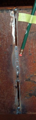

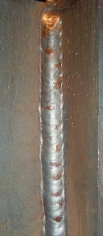

Having issues welding up and down a joint ... going up is OK, but going down ... yikes. So, how do you control the puddle? I was thinking of a wider bead, but no time to try tonight ...
Images below ... guess which one was going down :bounce:

When welding vertical, up hill usually gives the best penetration. Down hill is used for sheet metal typ 1/8" and lighter as you will burn through when trying to go uphill. On the heavier metals when going down the weld just kind of "hangs" there and falls away without penetrating the base metal. I would say pic 2 was done down hill and the pic was taken after the part was flipped.

With welding down hill, you can use a slight upside U or V movement ( push the weld into the root). Uphill welding is a regular U or V manipulation. Uphill is stronger if both are done correctly. Check out weldingtipsandtricks.com for quick info on techniques.

Yea, the skinny one is down hill.
So an upside down U when going down hill? Does trying for a wide bead help at all?

You can spread it around a bit, if you like and not sit in one spot too long, (slow the wire speed down so it doesn't droop) but it's really not going to penetrate as much as uphill welding. Usually, the weld doesn't need to be any wider than the thickness of the material. When welding "around" something, it's sometimes best to tie in our wrap your welds.

Turn it down for vert up, set it for 1 thickness of material less and the movement is a Z with a pause on each side. When setting the welder its not a turn wire up or down which is the "heat" by the way but both controls. The wire feed has 2 dials unlike a simple stick which has 1.
Up or down same strength if done correctly.

As others have said turn down your volt's
Its really turn down the wire speed. I don't know if the last 2 are mine. Looks like it was a bit hi on the last one and it didn't get flattened out.

Neither one of the OP's welds is suffering from a lack of fusion which is the usual problem.

Looks like excessive cap, unequal legs and I'm possibly insufficient penetration at the throat of the weld. What stress level is this joint under??? Yes, most likely would not pass a visual inspection in my weld shop. It's always difficult to tell from pics. I'd cut it and examine the cross section and qualify the procedure to be sure. At the very least, please tie the horizontal and vertical weld together.....Wrap the corner. If it's under stress be safe than sorry.

I'll grind it out a redo it, and start practicing wrapping the corner. This particular joint is just a cross brace so not to much stress.
The uprights might be the most stressed, since they will be carrying the majority of the weight. I'll get some more images up later tonight ... thanks for the help all.
