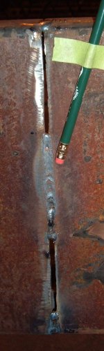

You can do it any way you want but gaps are used all the time and not every joint needs fussy fit.

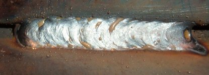

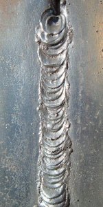

Ok, using the .030 wire with 25% shielded gas. Here is a picture of a weld that I was working on from above the weld. Easiest position for weld. This is a cut **** end welded to the long run of the 2" x 3" x 3/16" tube.
This next picture is welding the end of the tube standing on the base plat. So I have a 90 to weld into. I tacked the 4 corners and then ran the bead.
I got good penetration on both welds, and welding from above is an advantage.
I tried a vertical weld, but it is NOT pretty, and I'm not sure I got good penetration on it. So I'll grind it out and try again by laying the frame on its side. Unless I feel brave enough to try it again. I am not going to try overhead at this point.
sberry
Jun 18, 2005
35,747
Brethren, Michigan
That is pretty freekin good especially for learnin. Well melted in. The word penetration is often mis used. Pentration is like I showed in some of the joints, filling and burning all the way thru and is mostly a function of joint design, I say mostly but fusion is the melting like in a typical fillet weld, simply making sure both pieces are well melted and its not just laying on top of it.
