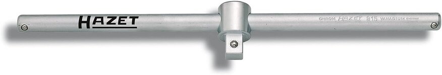

Speaking of sliding T-bars, those from every manufacturer are miserably short. Probably made sense when people were spinning off nuts with these things on a regular basis. But now I use them for the pure-torque applications that F-22 mentioned and would like more length for more torque, e.g. while removing a bottom bracket from a lightweight bicycle frame.
I can’t think of a time on any project when I had room for a tee bar! To my thinking, that tool is more old fashioned than a normal breaker bar, which I don’t even own anymore. Cool functionality though, and yes F-22, understood.
I've found a good use for them: with an extension and a torque adaptor socket to make a limited clearance/obstruction wrench. Great for carburetors (which is what I used that exact combination on just yesterday!)
