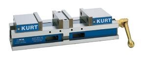

I also picked up these at the same time, but they aren't marked...just three threaded holes, and are physically bigger than the others.
ninjamunky85
Jan 22, 2015
63
They look similar to the center part to a double vise like this.
