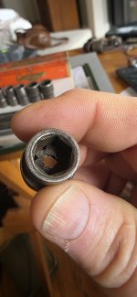

I found these in an old box, rusted, probably to fat gone except for one. Would like to know their use, details etc. I realize photos are poor, can take more if anyone requests.

Another pic of the cleanest socket. Since most of these seem so corrode, is there any value to them or are they just scrap?

^ you've got at least two different makers there - cross-hatch knurling and straight knurling - and the straight knurling appears to be fairly deep, which eliminates the obvious possibilities.
are there any other markings on them other than the sizes? (and the two dots stamped alongside the " 9/16 " on the second image?) are the sizes on the darker two stamped as we would see them today? (i.e., 9/16) or as they were formerly stamped by some makers early on? (i.e., 9-16) ??
"value" depends upon whether or not somebody needs them to complete a set.
determining who made them might present a challenge.

Four Cycle, I can't even read anything much anymore, they're too far gone. The straight knurling is the only one, the rest have cross hatch knurling. One pictured here reads 7/8, with the seven over a horizontal line and the 8. image.jpg
29,545
you got me. there's only a couple of those makes I can identify by sight.
you can try picking through photos at Alloy-Artifacts.org or ToolArchives.com... or hang loose and wait and see if another member here knows what they are.

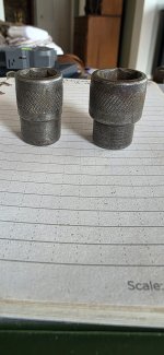

Glad this old thread resurfaced. I had never seen a hex drive socket set before. Turns out I have a "partial set" (one part only, that is ;)) myself:
There aren't any ID markings on it. I had always assumed this was a specialty tool for some long-gone piece of equipment.
29,545
^ It has to be exactly that length to fit into the holder.
