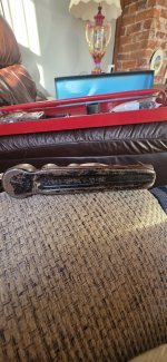

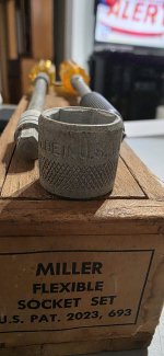

Leon B. (L.B.) Miller set #212 1/4" hex drive set. The flexible driver handle is marked on top of the handle, the flexible straight blade screwdriver is unmarked. Sockets are only marked as MADE IN U.S.A. and the size (ie. 1-2). The steel finish on this set is chalky possibly due to oxidation. My set is missing the 7/32 socket so if ya have an extra, hit me up. I have an extra 1/2", 3/8" and a 3/16".1000022334.jpg1000022335.jpg1000022336.jpg1000022337.jpg1000022338.jpg1000022339.jpg
30,989
Leon B. Miller thread with examples of other sets, company information, the patent, etc, and links to other threads with L.B. Miller sets, if you're interested, linked here.
Another possibility is cadmium-plating. While typically and unfortunately sometimes exclusively associated with WWII as an alternative to chrome-plating, it was a common, much less expensive finish for 'economy' or 'price line' tools before and well after WWII, and very popular with outfits like Oxwall and G.M. Co.

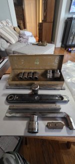

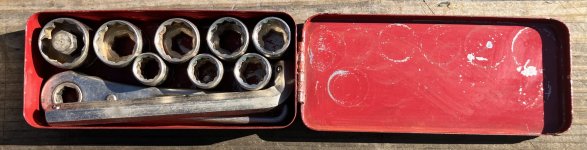

Here's two 1950s Indestro sets (1451 and 1351). Both are 1/2" hex drive. Both sets have unmarked sockets (except the size) with the single tire track knurling. The ratchet on the 1451 is unmarked but notice the typical Indestro hollow rivet near the working drive end. I'm missing the 7 1/2" L handle on the 1451 and two sockets for the 1351 set. I have a complete set of sockets without a casing but they are a different plating and slightly taller.1000022343.jpg1000022344.jpg
16,708

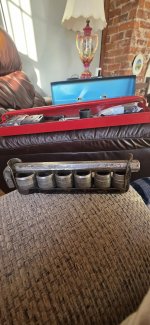

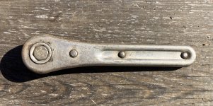

I don’t really go after hex drive tools but sometimes they find me. Here is an Indestro set. IMG_0525.jpegIMG_0524.jpeg

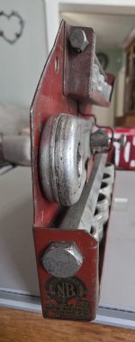

Here's a late 1920s New Britain Handle Lock 1/2" hex set. Sockets are unmarked except for size (7-16 to 15-16) with cross hatch knurling. Ratchet and sliding T bar are unmarked, the 6" extension is marked, Made in U.S.A. and patented Dec 12 1922. The "L" handle contained the info for the Handle Lock set. 1000022352.jpg1000022353.jpg1000022354.jpg
29,776
@Tom "Python" Aycock -
That Dec 12 1922 patent is the Henry H. Chase patent on the holder (below)
They used the same patent number on a variety of different holders - not all of them shaped anything at all like what is in the drawing in the patent document.
Indestro did the same thing - all kinds of variants on the holders, all using the same patent numbers.
To an extent, Wakefield did the same (see my 8R set posted here in the Wakefield thread - looks nothing at all like the drawing in any of the patent documents.)

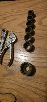

And, I just picked up these hex sockets at the flea market and I have the 3/4 but then it jumps to the 15/16...looks like a perfect fit for the 7/8th. Don't have a box or wall set yet to put it all snug together but there's plenty out in the wild!1000023235.jpg

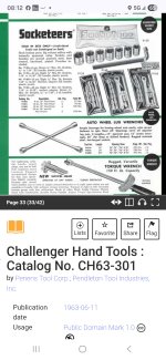

Found today at a garage sale...1/4 hex drive Socketeer No. 9150. Double tire track knurling with Made in the U.S.A
Nice find. That's a Penens (Plomb Tool Company subsidiary) product.
Tom "Python" Aycock
Nov 27, 2022
431
Excellent! I found this catalog on ITCL Challenger by Pendelton Industries but don't see the 1950s catalogs mentioned in your post (or @Oldtuleguy OP). Thanks for sharing and getting me a brand to attach this too!1000023351.jpg
29,776
But how do you connect the relation of socketeer with socketool?
errrr.... got my wires crossed in my head again.... nothing out of the ordinary.
I do it quite frequently.
Yes: two completely separate entities:
Socketeer / made by Challenger / https://www.garagejournal.com/forum/threads/socket-maker-id.488011/#post-9274299 /
Socketool / see Shelton /
I wasn't even aware there was a separate thread on the "Socketeer".
I should remember to check my own list before posting some times, eh? :unsure:
30,989
I didn't mention any catalogs, just the TM (first use 1954). As for the 1955 catalog OTG has excerpted, I suspect he has not scanned or uploaded the whole thing to IA/ITCL.
You're welcome.
This is just idle conjecture, but I am not convinced the tools were actually made by Penens. The construction features of the sockets, the L handle, and the ratchet do not look like anything else made in the Penens factory. The tools and the packaging are classic G.M. Mfg. Co. or an outfit like them.

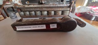

Just picked up another NB set #1001. This one looks and feels older than the one in post #48 above. The difference is, not a red enamel finish on the holder and cross hatched knurling versus the tire track style. I'm thinking this set preceded the 1936 set, perhaps 1920s...?1000023483.jpg1000023484.jpg

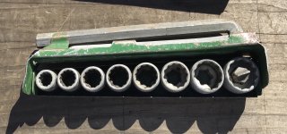

And here is an Indestro 1/2 hex set from late 1920s, early 1930s. Closest I could find on ITCL was a No. 1207 hex kit in the 1935 catalog...but that set is with 12 point sockets. So...would this possibly be a set No. 607 (due to the 6 point sockets)? All these sockets have the five point star on both sides of the measurement.1000023494.jpg1000023493.jpg1000023495.jpg
