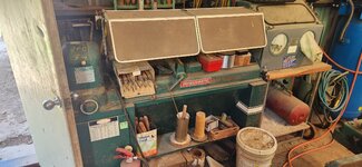

I got invited to an elderly man's shop today to take a look around. While I was there he told me and my friend that his mind was going and he was going to have to leave his place and wanted to sell all of his tools. He was a furniture maker and has a ton of wood tools that I do not have room for but would love to have. These are a few items that caught my eye and I want to give him a fair offer on them.
1. Holley tune up cabinet
2. Craftsman 101 lathe (works with attachments)
3. Anvil unknown size
4. Reed 204R vise unknown year (works)
Any help will be greatly appreciated

$500 is a steal but $900-$1000 for the pile is what I would be selling it for. That said how many of the lathe accessories are there and what is in the cabinet? That could sway the price a bit.
cvairwerks
Aug 12, 2016
7,233
Within hearing distance of Texas Motor Speedway

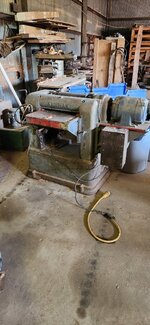

The Doall is in dire need of some help, but should bring 1K or more. The Newman is going to be probably in the 1.5K+ range and the table saw around 1K. The Powermatic lathe is another at 1K+.
Both the Newman and the Doall are most likely 3 phase machines and you won't have the power capacity to run the planer at home. It's most likely got a 15 hp motor.

For those valuing the metal lathe, it appears to be a 6", not a 12". There are no back gears, or way to engage them. This means it is a much lighter machine, capable of less both in capacity and rigidity. I would be surprised to see it sell over $400, due to that. If it was a 12", then the $400-600 range would be a bit more accurate.
Could someone give me some tips on what to look for when purchasing a lathe? Again I am a mechanic and want the lathe just to learn on. I have zero experience with machinest work!
Ideally, you would put it on a surface plate, and see how much wear the bed has from end to end. If you can feel a ridge where the saddle slides vs the rest of the bed rail, that is another way to rough-test. Take each piece and make sure there is no slop or shake in it. If possible, turn it on, listen and see if it is making any bad noises and if everything moves freely. Check under the headstock cover for the biggest gear, see if any teeth are worn/broken (sometimes happens when trying to remove a chuck).
Based on what I see, the lathe is super basic. There should be several change gears, so you can vary the amount the lead-screw (under the bed) turns compared to the chuck. It looks like a three jaw chuck, which is ok, but not as versatile as a 4-jaw. Hopefully he has other tool holders (the thing sticking out of the cross-slide), both straight and a left-bend.
Any other accessories are helpful but could be sourced elsewhere (depending on item, $$ to $$$). Things like a steady rest (looks like a a mounted circular guide with arms sticking in), a heavier tool post, a 4jaw as mentioned, a follow rest (kind a curvy shape with two arms that would bolt behind the saddle), a micro-stop, etc.
Also see the first part about sizing. Atlas made a 6" and 12" lathe (total diameter of swing, so ~3"-6" from bed rails to center of chuck). The 6" were most commonly 18" between centers (from chuck to front top of tailstock), whereas the 12" can go from 24-36".
