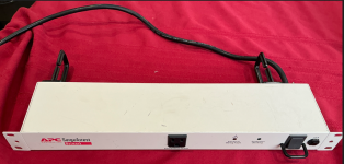

The next part is power distribution. A power strip would work, but I had a APC 1U rack mount power distribution module in the junk pile. I really like that it comes with a ~20' heavy duty integral power cord and cable management brackets on the back. I will mount this in the end of the cart just under the top shelf. I need to get some child proof plugs for the unused outlet or make a shield to keep dust out of the plug area.
