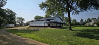

Hello I had my 48x80x16 building put up this summer. I have ran 200 amp service, Ethernet cables, plumbing and rough in sewer. Concrete will be in the spring. My question to you all what do you regret most that you didn’t do and wish you did?

I wish I put PEX in the slab for radiant heating. At the time (34-35 years ago), there weren’t any reasonable $ options for boilers, so hanging a unit heater seemed logical. A few hundred spent then would have been cheap future-proofing.

I have a full bathroom already stubbed out and In floor heat prep. I will buy the foam board soon when a good sale comes with my Menards rebates I have.

My biggest regret is not being able to finish the workshop before moving into it. It was a bigger job than it needed to be to move everything out to get the insulation and drywall crews in. I should have done the mini-split for heating and cooling much sooner - a comfortable shop is a great place to work in! The absolute biggest was not doing some sort of floor covering like epoxy when the shop was empty. The way everything is set up now I can't clear out enough stuff to do the floor.
I have outlets every 4' along the walls. Doing it over I would keep the 4' spacing but consider two rows of outlets - one at the usual 12"-14" height and another above it at around 50" high. On separate circuits, of course!
And, of course, not building a bigger shop...

That’s a good point about the spacing. I planed to run outlets on every 8 foot pole spacing using same circuits on every other post to keep from over loading at one area. The top and bottom on different circuits is a great idea as well. I have bough 2- 1000 foot spools of 12/2 wire and 1-1000 spool of 12/3 for the 3 switches. I am going to use smart relays to run over head lighting. Each door will have a master switch and then you can turn on or off lights to conserve energy.

Yeah, 8' is way to far apart. Even at 4' I don't always have an outlet where I want it. One thing to consider is that outlets end up hiding behind things.... One of the many reasons more is better!
If you can plan ahead, burying some electrical outlets in the floor can be really convenient. For example, if you have a big island work table it would be nice to power it from below.
Also, check the height of high outlets. I ended up building a Steevo bench (which is great) but the outlets behind it are almost too low to fit. I planned ahead, but not far enough ahead...
I didn't do it, but consider setting up the overhead lights so you can turn on just one or two fixtures. There are times when you need a little light but don't have to have full daylight brightness.

I did each outlet as a double duplex, and each left outlet was a circuit and the right were another circuit This allows a shop vac and a chop saw to be plugged in next 5o each other and running on different circuits.

With my building I have a 40 circuit 200 amp panel I can’t run multiple circuits per plug. I plan to have enough in the area I plan to work on race cars and automotive side work. One side of shop will be mainly storage and parking race rig and trailer. I might be able to not use as many circuits on that side and heavier on work side with the lift.

To your question about the shop though, not doing my floor when it was still empty. Do not make that mistake if you can help it.

Others have mentioned finishing the floor before anything goes onto it. I'm really glad I did that, but wish I had chosen different flakes for the epoxy coating. The floor looks superb, but if I drop anything on it, it whatever I dropped instantly disappears. Many's the time I've had to fetch the push broom to make that escaped item reappear.
I'll go further to recommend finishing the interior of the space in its entirety before moving anything in. I wish I had fixed all of the drywall issues in mine when the space was totally vacant. Now, access to the walls and ceiling is a challenge, and just thinking of all of the dust that I would generate sanding a bunch of drywall mud makes me not want to even ponder it.

4 wires though each conduit on a run. Black, red, white, green. Left outlet’s get hooked to black, right to red. Share the neutral and ground. I have a dozen quad boxes on these 2 circuits.

I understand how to wire circuits. I was referring to having multiple circuits per plug every 8 feet. I would not have enough breaker space in my box.

That’s our thoughts. We will have a 24x24 patio outside with a 24x24 loft and down stairs bar area by the bathroom. The shop is only 100 feet from back of house but felt the bathroom was needed for so many reasons. It’s not cheap having the sewer bored but years from now I didn’t want to regret it.
