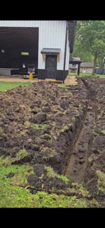

midwest_diy
Nov 1, 2025
13
No floor drain?!
That’s what I am looking into. I have drains in the utility room and wash sink area. To tie into sewer a very costly oil separator is needed. I was quoted $5600 for the separator alone. I plan to do the far bay with 16 foot trench drain. The work area I want flat because I drag race and chassis set ups are very important to have flat ground. I can wash floor and squeegee to drain that will tie into my dry well I did for the gutter drains. I have 6 of these plastic drywells with 14 ton of clean rock in this 9 foot deep 10x16 foot rock catch basin under ground in the back yard.
