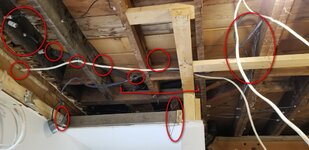

This was the ceiling area of part of the old house I renovated a couple of years ago. This area had a false ceiling framed with 2x4s and this is what I found after taking the ceiling down.
How many code violations do you see here? Not just electrical, but plumbing, framing ....
There are so many issues here and you cannot even see them all in the picture. The smaller pipe going off to the left side was a lead drain pipe and it was just caulked into the ABS pipe at the wye.
P.S. the knob and tube wiring is sill in use in this picture. The taped off wires on the left were still live.
