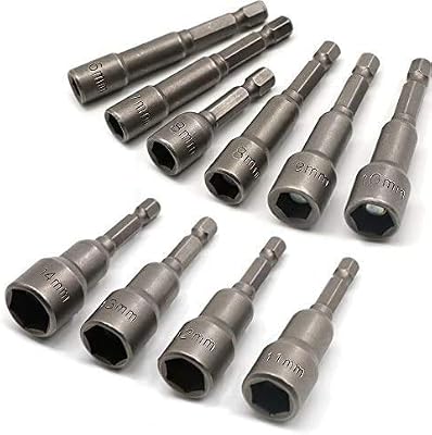

What is magnetic nut setter for?
Jacobson
Jan 11, 2014
1,482
What situation calls for this tool ?

I use them all the time doing dash work in semi trucks really nice not dropping screws down deeper in the dash.

I used one earlier today for putting garage door bolts in without dropping them everywhere.

I wore out several of them (1/4" size) running ALL 3000 screws to attach all the metal siding and roofing on my shop. The 5/16" size I use for running a bunch of tek screws. They are a very useful 'extra hand' allowing you to stick the screw in the nut setter then just point and screw it in without having to bend down and use both hands to install each screw.

'Magnetic nut setter' kinda explains everything. Remember those times you held a nut over a thread with one finger then tried semi-sucessfully to turn it with a finger from your other hand? Well, these tools make that easy. Next thread: What does a screw-driver do?

They have many uses holding nuts and bolts for easy starting with a drill or hex impact but the best use is for self drilling screws.

I use them for the galvanized / painted screws in downspouts. Keeps the self tapping screw in the bit so they are easier install. Could be handy for any self tapping screw.

Can’t be beat for repetitive jobs when chucked in a battery powered impact driver. Irrigation T bolt clamps for instance & of course metal roofing screws.

Metal cladding siding roofing any construction crew has a bunch on I’ve put in thousands of screws with them **** when your lining up a sheet of tin with one hand drill in the other and your screw falls out.:willy_nil

HVAC work , you'll wear a 1/4" version out.
When I was a tinner doing residential and commercial work, I only got about 3 months out of a good one. Doing under slab duct work was particularly brutal. On service calls, you'd often be using a 5/16" and 3/8" opening up a furnace or condenser unit.

Driven thousands of self drillers and zip screws with them. Good for pulling screws out of equipment also.

I use the 8mm and 10mm metric versions all the time in repetitive motorcycle work like removing engine cases.

I first encountered them driving trailer screws working on setting up industrial camp trailers. Trailer screws are a #8 sheet metal screw with a 1/4" hex head. You also see larger ones used on sheet metal siding. The magnet holds the screw. If you have a travel trailer, you Need one in 1/4".

I use them all the time to set nuts. Mainly use 5, 5.5, &7 mm or 1/4 & 11/32. Used in electric equipment , LCD panel replacement, ac/dc power supply repair up to 2500 watt. Common use for electronic type work.

I get the privilege of using magnetic koken and apex nut drivers everyday at work. If I werent so cheap I'd buy me a good set of them. The magnets are very good for nuts and bolts. We mainly use them because it makes the manufacturing process quicker instead of fumbling around with nuts and bolts.
The magnets do wear eventually usually the spring starts acting goofy, but they last a long time in an environment where its being use amd abused non stop all day
