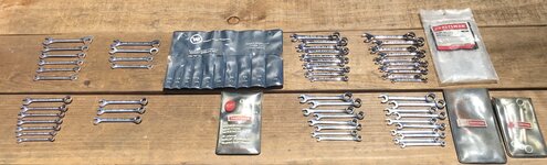

Here are some I had out yesterday. -v- marked are on the right. Upper wrenches are ignition wrenches while the lower wrenches are mini combo wrenches. Some combos are all one size while others are two sizes. I had them out to compare to some very similar Wright wrenches I found in a roll.
