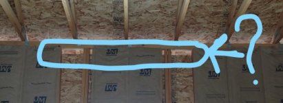

Hey,
I have a 40x40 shop I got when I bought my house. The previous owner started doing bat insulation on the walls and skipped all the areas that one would have to cut the bat vertically. I would like to finish the insulation job but, before I do there is a space I can't understand why it is there.
Does anyone know if there is a purpose for this space in the picture?
I am thinking it is not supposed to be there.
If not does anyone have any suggestions on filling it?
Any advise is appreciated!

The spaces exist to continue 16" on center framing. Just cut the insulation and place it, but don't compress it.

Thanks for the responses guys.
I had a drawing on the picture that apparently did not transfer in the upload.
The space I am talking about is just below the top plate on the wall.
The space runs parallel to the top plate.
My concern is I think I have to fill it, meaning take down the insulation at the top and put some sort of filler in that space.

looks like they didn't sheath all the way to the top. that area is likley behind the soffit area, you could leave it or staple on small pcs of ply or osb from inside to fill it
That is what I was thinking, ***** because this space is behind all the insulation that is already stapled down.
I would make sure it is within the soffit, when installed - or wire meshed and enclosed somehow. IF not, it will be an easy in for critters/weather/birds/etc.

OK, so now you have clarified, and are not asking about the obvious unfilled wall area, but the sheathing gap.
I am not aware of any purpose to intentionally leave that gap, best I know the framed wall was slightly overheight for the sheathing, but it may be within soffit height, so may be ok to leave.

Is that gap between the OSB and top plates continuous? If the OSB is supposed to be shear panel, then it's wrong, as it needs to be perimeter nailed to create a diaphragm. As installed, it's just wall covering. If you want it to act as shear panel, I would cut 2x6 blocks and install them tight to the bottom of the layout plate, then add a Simpson A35 from the block to the plate and lastly nail the OSB into the blocks with 8D's @ 6" O/C.

Yes the gap is continuous.
I don't know if it is supposed to be a shear panel.
I would have to nail the blocks to the OSB from the inside.

Its a poorly sheeted wall. What tool fool os saying for added strength you could finish filling it in but i assume there is already finished exterior wall and all that insulation in the way.
Being you just bought the house the seller may be liable to fix that but in the other hand it may not need fixed at all.
If therebis vented soffit on the underside of the roof eves or just and open eve the spaces are mainly for air to vent to the roof to keep the attic cooler and dry. It doesn't need the sheathing gap though.
Chances are its not needed to fill in that gap. I would just finish the insulation and put up wall covering and a ceiling or whatever your plan is.

The exterior is finished and there is vented soffit, so this gap leads to a covered, vented space.
My main concern is air flow into the insulated cavities. Does this even matter?
I assume a big gap like this make the insulation a lot less effective.

The purpose of the space is that the builder cheaped out or didn’t know what he was doing - or both. Yes, that space should be sheathed. Yes, it will affect the insulation of the wall - you’ll have a cold band along the top, which could also lead to moisture issues. Chances are it would have failed the framing inspection if shear walls were needed.

Are you planning to finish the insulation and install a ceiling?
If yes, even though the soffit is behind the gap, I would still want the area sealed off in some fashion to keep wind driven moisture out, and insects, etc from getting into the wall space...
Maybe cut 2x4's to length, and pneumatically nail them to the underside of the top plate, stacked if need be to fill the space... followed by a bead of spray foam around the edges.

I would want it blocked off. Cut 2x6 blocking and toe nail it in perpendicular to the top plates. It'll also assist in some shear strength.

Nailing thru the block into the OSB would be better than nothing, but it's not truly effective for an effective diaphragm.
I'm not a framer. Why would adding the 6" bit of OSB to the top change anything? Or perhaps I should ask what is a shear panel? Is that meant to prevent racking? If so then all the other OSB panels, especially the ones in the corner would do the job.
Yes, shear panel is to prevent wall racking by creating a diaphragm, but the only way to create an effective diaphragm is to have complete perimeter nailing, and the diaphragm need to be continuous from bottom plate to top plate.

It will also create a 'chimney effect' and reduce the true r-value of the insulation greatly.....the insulation should be sealed in all 6 sides to achieve its ratings....

Yep, looks like they intended to box in the soffets and only carried the OSB siding up to where the soffet enclosure would reach / cover. Penny wise and pound foolish, to me. I wonder what else they cut that fine. how's your rafter / truss spacing, roof deck thickness, screw count on the metal roof / siding?

Well I decided to cut 2x4s and spray foam it like suggested.
Thanks for the advice guys!
