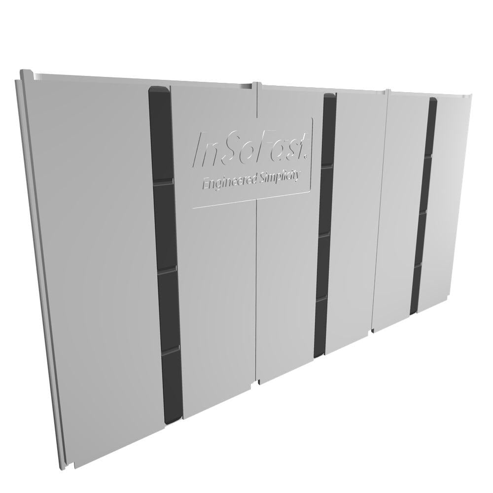

What I did for the stem walls (2ft high) is get some InSoFast insolation panels (2x4) cut them so you now has 2x2 panels
use the glue specified which I think was PL 400 ( Premium?) let it set up and then I attached white smooth FRP panels to the ribs with counter sunk screws and washers.
Goes up fast.
