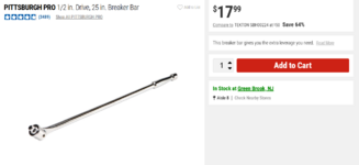

I'm a petite middle-aged woman and I had a flat tire on my car yesterday afternoon. I know how to change a tire, but I was unable to loosen 3 out of 4 lug nuts. I used a lug wrench (the crossbar type) but I just couldn't get them to budge. I had to find a man to ask, thankfully I was in a parking lot. But had I been on the side of the road, this could've been potentially dangerous.
I'm not sure if I'm just too weak, or if the lug nuts were possibly overtightened. Would a breaker bar be better or should I look at something like these roadside impact wrenches that run off the car's battery via the cigarette socket?
I guess I could get both. I guess the point is that a man removed the remaining lug nuts with the lug wrench, so clearly I was not strong enough. Is a breaker bar gonna help me in this situation? I was trying to use my weight with the lug wrench, and I tried pulling and pushing. I exhausted myself. I asked the man to help and he loosened them like it was nothin'. 😑
I would appreciate advice. This is the second time I've had a flat and was not able to loosen the lug nuts. I don't want to be in this situation again.

All of our vehicles have the oft mentioned HF 25" breaker bar and a socket that fits the lug nuts.
I keep a set of flip-sockets in 2 of the vehicles I normally drive to help other drivers if needed.
Costco Michelin jump boxes were given to everyone this Christmas and each car also has standard jumper cables.
Cheers
Jim
