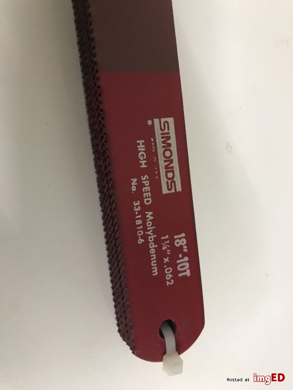

I was thinking a pry tool for roofing or flashing of copper or aluminum. I have one very similar but it has a small 'V' cut into it for lifting nails as well.
jask
Jul 4, 2009
314
Gods Country, B.C.
they look like homemade tools.. probably from old power hacksaw blades. any chance he was a bee keeper? that looks like it would work as a hive tool.
JR 42
Nov 2, 2013
966
Sunny Seattle
I was going to say they look like they're made out of old power hacksaw blades (high speed steel has molybdenum in it to achieve high hardness and resist heat), but no idea for what purpose.
Millwrong
Feb 4, 2018
369
Canada
I think the guys are on to something here. look at these old blades from Simonds. Looks awfully similar lol!
JR 42
Nov 2, 2013
966
Sunny Seattle
Good eye! I can't find any info on the other one, my weak googlefu just gets me a bunch of high schools and random distributors and stuff.
