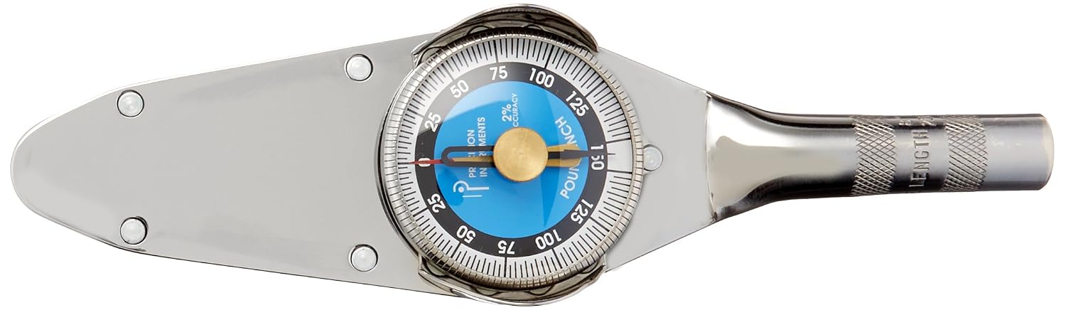

VoodooCLD
Sep 12, 2014
413
I prefer the dial type torque wrenches for ratings that low. I don't trust the click style ones.

Dont get a dial unless your application you can always look at the dial. I had a dial only at one point, then I had to torque something on the side of the engine and the line of sight was impossible to read the dial.

Precision Instruments makes those dial torque wrenches for SnapOn. You can get the Precision Instruments version with a light that illuminates when the torque is reached so you don't have to see the dial. Any Precision Instrument dial torque wrench with a model number that ends in "L" has an indicating light on it. The lighted versions are about $60 more than the non-lighted versions.
By the way, I would never buy one of those torque wrenches from SnapOn. Snap on charges $384 for their pretty red dial. The EXACT same torque wrench is $134 with the blue Precision Instruments dial. You are paying an extra $250 to have the same factory put on a red SnapOn dial.

The PI wrench in the link is not the same as the SO that I linked. First the SO is 0-150 in/lbs to the PI30-150 in/lbs. The second is the SO is an FU model with the follow up pointer and the PI does not have one. The SO FU models cost more than the basic ones. They are still a great deal and were not popular or available when I bought my two SO Torqometer.
What is different other than the dial color?
The PI dial goes from 0-150 in/lbs just like the SnapOn. The description says the range is 30-150 because they are only calibrated to be accurate from 20%-100% of rated torque. 20% of 150 in/lbs. is 30 in/lbs.
The "M" in the model number indicates that it has a memory pointer. SnapOn call this same feature a “Follow Up”.
There are several options available for all the PI torque wrenches. The numbers and letters of the model number tell you what options your torque wrench has. You have to go by the model number, not the generic photo supplied by the PI website.
Precision Instruments D2F150HM decoded...
D=Dial
2=3/8" Drive
F=Fixed Drive
150=Max range
H=In/lbs.
M=Memory Pointer
Here is what the Precision Intruments D2F150HM torque wrench I linked actually looks like. The dial goes from 0-150 just like the SnapOn, and it has a memory pointer just like the SnapOn.
