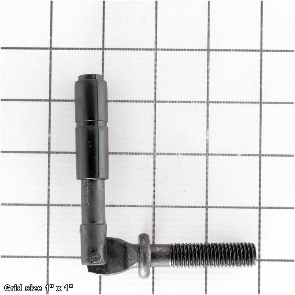

What’s it called? Flippy lever bolt thing.
no704
Apr 27, 2016
5,272
This is on a drill press. I would like to find something similar for my milling vise stop. The cap screw and loose allen wrench *****! Thread is 10-24. Thx

I would call it a quick release or cam release. Bicycles use them for wheels and seatposts but those are much smaller. I've never seen an M10.
dscheidt
Apr 26, 2017
2,959
It's some variety of adjustable handle, but I've never seen that variety for sale or listed in a catalog, just on tools. The commonly available kind use a bolt, and the handle is a wrench. spring tension keeps it engaged, but you can pull back to change which flats it's engaged on. should be available from your favorite industrial supplier.

They're not a cam, it's just a folding lever attached to screw threads. Folding lets you turn it fully, even if it's too close to an obstruction, and you can easily spin it for large adjustments.

Might have to build some. Id much rather find something off the shelf. Ive seen them smaller but don’t know where? Drill press is the only example i have on hand.

My Jet drill press uses the same part. I would assume you could order a replacement as a spare part from Jet, Grizzly, or some other tool seller.
Edit to add: In a 10-24 thread? That is way smaller than the handle on my drill press, so ordering a spare in that size is unlikely unless you can find a tool with a similar handle that small.

search for an eye bolt or a cam bolt clamp. With a machined eyebolt you could make the handle.

Not sure I've seen them that small. Maybe I have but not exactly like that. The ones I've seen that were small have a sheet metal "lever". I think I would shoot for a thumbscrew vs something with a lever. It would **** breaking off a #10 screw in a vise jaw.

The # 10 screw is the vice screw co to speak. Its just a vice stop. Its basically a cap screw with an extended cap with a handle on it.

I think this is more what you're looking for.
Yeah, I think it's one of those things the manufacture name became the generic name, sorta like "Kleenex" but I can't think of it.
As far as a cam lock I don't think you will find one that small, as I believe someone else said, at 10-24, or even 1/4' taking a lot of material out of the stud for the cam.

I wish I knew. I've made a few of them over the years. Not hard to do if you have access to the right machinery. They are common enough that it's hard to believe each is custom made for the application. Nothing I've searched has come up with it though. In the time I've spent looking just now, I could have made one.

A quick search yielded the results below this does not have the floppy handle but the spring loaded style providing much more leverage. Example below is metric but also plenty available in sae. Keyword search is "spring loaded clamping lever"
Example products​
  • Morton M6X1.0 Adjustable Clamping Lever
  • RS PRO Adjustable Clamping Lever M10
Also if you really want the cam lever style Carr Lane sells them in various thread pitches:devilish:

So it's a "lock handle", very elusive name
seems to only exist as a drill press table direct replacement and not a more universal piece of hardware? Makes sense I guess, not a terribly great design.
Same style is used on a couple of my drill press vises, so it's not completely unique to the drill press itself. The one like I posted a pic of I've seen in a few places, like on an xy table, funny enough, for the drill press. Ok, maybe it's unique to "drill press use" items.
