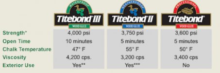

I've always just used regular red-label Titebond, but the guy over at Project Farm tested out a bunch of glues and recommended Titebond 2, Titebond 3, or Elmer's Max.
So it's got me considering switching to a "better" glue, but I figure there's got to be a tradeoff besides cost here. Open time, workability, cleanup, paint/stainability, something. I've used Titebond 3 in the past but only when I specifically needed waterproof glue; I never used it on general woodworking projects.
What's your regular go-to wood glue, and why?

Always TiteBond 2.
Main thing for me is it cleans up with water and doesn't affect finishes.
If I was using it outside I'd probably go with a polyurethane construction adhesive.

Titebond 2, Titebond 3, or Elmer's Max, there isn’t a lot of difference between the 3, and I use whichever is currently cheaper.

Titebond3. Even though most stuff I glue together won't get wet, I look at the water proof vs water resistant (T2) as a free bonus. I don't use enough to care what it costs.

TB3 Good open time, super strong and waterproof
For quick bonds on interior only items I just started using TB thick and it tacks and sets up and dries very quickly

Years ago, I tested TiteBond original (red label) vs 2 (this was well before 3 came out), when I participated in a basswood bridge building competition. I found that both had similar tensile strength, but the original was more brittle, so I ended up building with the 2, and never looked back.
In the years since then, I tried the 3 when it came out, and was pleasantly surprised. A thin film of the original formula would dry relatively clear (yellowish), but the same film of the 2 would have a milky white cast. For whatever reason, I haven't seen that white from the 3, and from what I can tell, 3 is equally as strong as 2.
I don't need the extra water resistance that 3 provides over 2, but since it dries cleaner, my vote is for Titebond 3.

Normally Titebond 2 but if I have a complicated glue up, I will use Titebond 3 for it's longer open time
