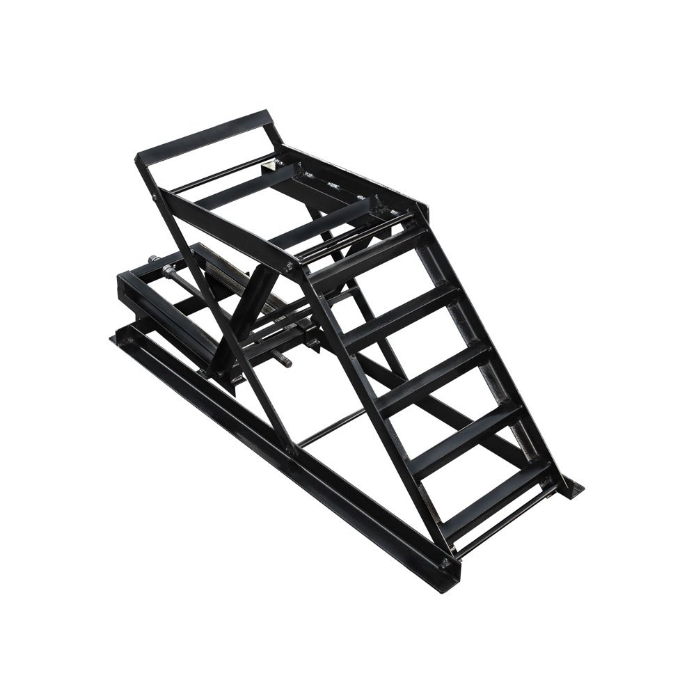

I just found this video demo of a patent lift stand arrangement that I could live with, but not sure if I would want to be fabricating them unless I already had the materials for no $'s.

greg13, good idea but I'm sure they must be heavy to move around.
My buddy put two big brake drum together to make a pot belly stove/heater for his shop.
Worked too well actually...
Bullnerd, you are probably correct, I have two that I discarded years ago that had the drive on ramp which both for me and other was highly risky drive up and stopping since that could flip forward by either braking or hitting the end stop.
Also on the wrong surface they could slide when trying to climb the ramp.
I had thought of cutting the ramp part off and just using them as a wheel stand.
I guess if I looked around at yard sales I could find another pair cheap and do the same to get enough for 4 wheels.
I was leaning towards using lumber but now you have got me thinking...
