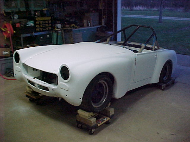

Wheels stands I built so I could actually work on a buddies MG race car. I did the 2 x 4 cribbing on top of a Harbor Freight furniture dolly. Raised the car up to working height AND made it movable... Worked very well...
Mark
