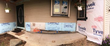

got some back fill today and started on the front... nice to see some "real" progress!

The first wall is going up today! The floor is poured in the crawl space under the new floor and the new front porch is almost done. No steps anywhere will be amazing!!:shocking:
