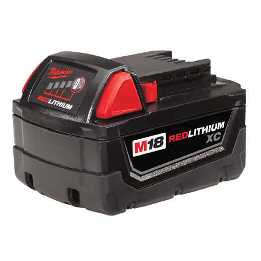

Genuine Milwaukee XC5.0 batteries for $64.99 each:
To switch from V18 to M18 batteries, I will need the adapter and new chargers. What would my best route for say 3 batteries, 2 chargers and an adapter be.
Might be able to get chargers on ebay or marketplace.
This hasn't been a priority, as I haven't turned a lick in months.
