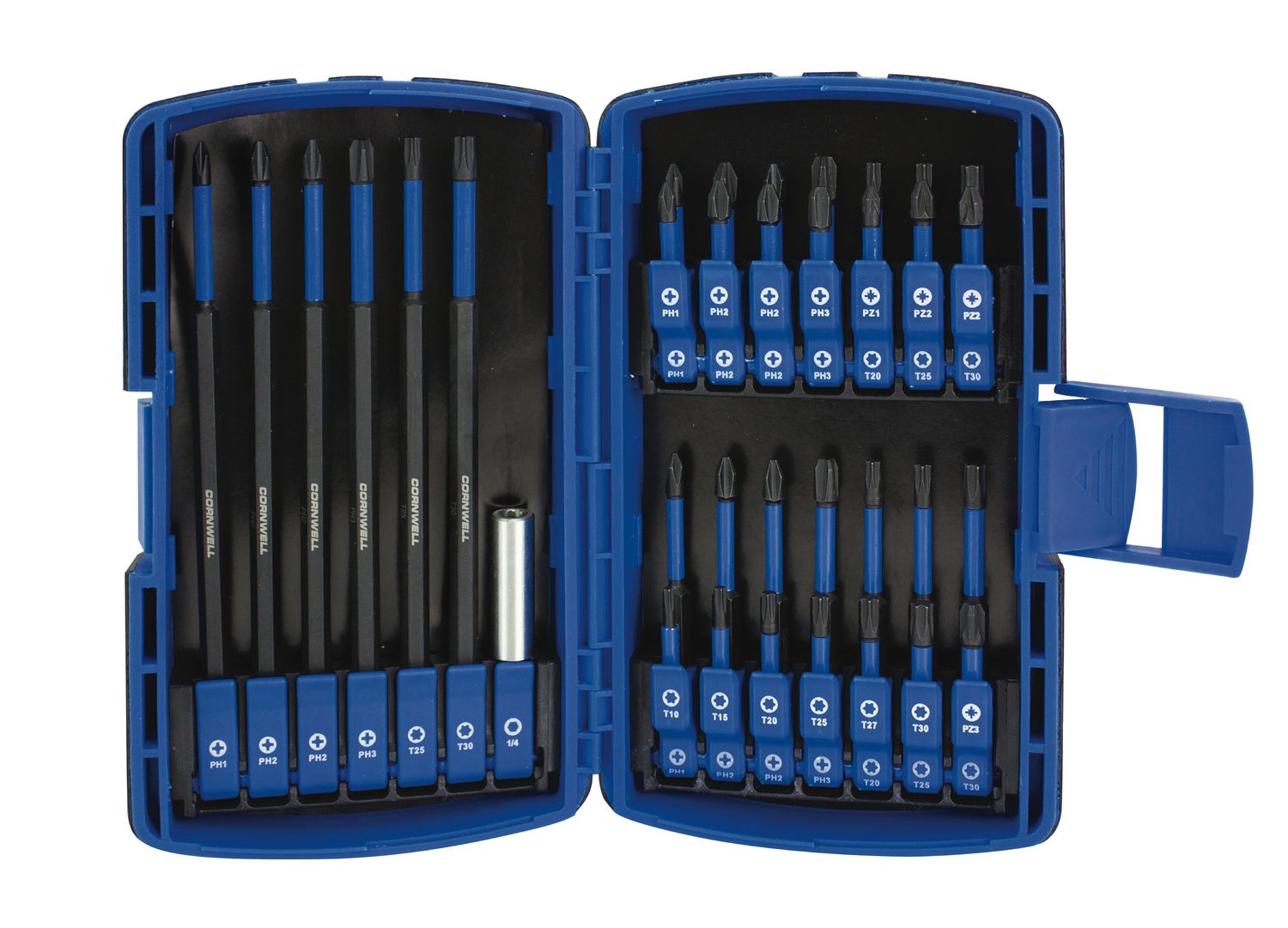

I got this Cornwell set on a monthly special. Same as the Carlyle set from NAPA, but lifetime warranty from Cornwell. Seems to be good quality.
