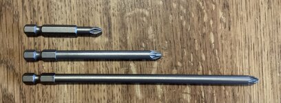

My most used impact is currently my baby 12v Bosch. I generally carry Wera bits with it, and I’ve found that the 3 1/2” do about 90% of what I need.
Though I have 2 inch and 6 inch if needed.
Wera also offer various sets with good selections of 1 inch bits. I tend to chuck one of these in my bag if ever I think I might encounter the unexpected, which is most of the time now I think about it.
The Wera set above, with 30 bits and a holder, can be had for the equivalent of $17. Not sure if they are comparable priced where you are.
