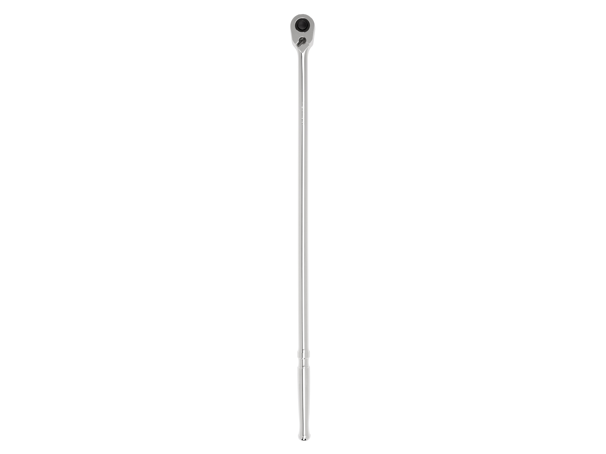

More great points from everyone! Just a few comments I wanted to reply to
I have a Matco 36" that I've broken the gear / pawls on multiple times. I'm gonna try and scoop up one of the locking flex head Icons during the black friday sale.
Any thought to a Platinum Tech 99682? It's a non locking 24" flex head, but also has another 20" handle that attaches to it. They claim it's rated to 700ft lbs. I don't personally have one but it's on my list of wants.
Appreciate the input from a fellow HD mechanic. I’m a sucker for weird tools and if this were a little less expensive, I’d probably order it now. I see they limit the flex head to 15deg either way, which is honestly pretty smart given the forces it’s expected to see. They tout the I-beam handle design as being able to allow the handle to flex, which I thought was a translation error, but the photo seems to confirm it:
Still, it’s oddball enough to pique my curiousity. I’ve also added to my list of wants.
Do you have a reason why head size is a factor for you? As I'm sure you know, I have and love the Snap On SHLF80A. The size of its head has never once been an issue for me. For me, it's probably the use case. I use this ratchet:
1) a lot
2) for pretty specific jobs, none of which require small head sizes.
My recommendations:
1) skip the head size as a comparator. Add the handle/grip you like. I personally like the Snap On soft grip, especially for this ratchet. If you love the Matco grip, maybe factor that in.
2) The quality of the flex is the other thing you should be factoring. I assume you didn't mention it because both are excellent. You don't want a floppy head on this tool. Locking flex would be a deal killer for me.
3) Would you consider a >30" ratchet? Looks like Matco makes one. Would that be a better choice for you? Feel like the 26" SHLF80A might be the standard length ratchet for semi's! I guess that means 18" would be the stubby! For passenger cars/light trucks etc, my 26" ratchet is long enough.
Head size is not a dealbreaker and unlikely to be a factor but all else equal, a thinner head is better. In practice, a thinner head may be less strong or have other issues, to which people have alluded.
>24” seems impractical, and I’d like to cover my bases with a two-footer first. Maybe one day I’ll truly have the need for something bigger….

Any Tekton owners that could chime in?They have a good reputation for tools
It’s gong to the same MIT ratchet available from about a hundred other vendors.
It’s probably just fine. For $75, I wouldn’t overthink it.
What @liliysdad said.
I tried some Made in Taiwan ratchets that I disliked. I like the Tekton ratchets. They are not my favorite but they cost much less than my favorites and they have a great warranty. You get a decent solid tool for a good price and a solid warranty. I had a problem with a Proto HTC Ratchet. Proto sent me a label, I sent the ratchet to Proto and a week or two later I had a new ratchet. I had a problem with a pair of pliers from Tekton, I had a replacement in a day or two. If you have Snap-On, what is your turn-around for a fix or repair? Off a truck you wait for your truck to stop by or maybe you deal with it by mail as well.

I did not read the entire thread ... tekton 24” extra long
When you get into the extra long size the flex head really shows it's value being able to change the length by angling the handle and lift up over obstructions. When I bought my long flex head I'm really glad I didn't also spend the coin on an extra long non flex head, it would have never left my box.
I wish Tekton would sell an extra long flex head. After looking at the Icon I'd be tempted to buy one if you think you'll just use the extra long flex head on occasion.

I have a SnapOn, Kobalt, and Gearwrench, all about that length.
They all work, with no issues. Unless I need extra reach, I generally use a battery impact in lieu of the leverage a long ratchet offers.
They’re all useful when you need something that long, but they all mostly sit in their respective tool boxes taking up space. Of the three, I like the SnapOn best.
Warranty is irrelevant to me.
You're brave putting any substantial amount of torque on that Kobalt ratchet. Even using it to change a tire, the deflection is wild. I still use it when I need the reach and a compact head (it's more like a 1/2" anvil in a 3/8" head, IMO), but I don't trust putting any weight on it. It was replaced by a Carlyle. Had I not gotten a good discount on the Carlyle, it would be SnapOn or Matco, likely in that order. Although, I like the Matco locking mechanism a bit better.
finn
Mar 27, 2005
16,652
The UP, God's country
Who uses a ratchet to change a tire?
That what impacts, either battery or air are for.
I use the long ratchets strictly for extended reach.
