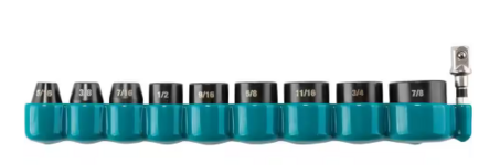

This probably doesn’t duplicate tools you already have. A more traditional pass-thru is also available for the same price with extensions and a 3/8 square drive adapter. Gearwrench, SATA, or Crescent whichever is cheaper. Small footprint.
How are these sockets both metric and sae? Slop in the fit allows it?
Etchase
Nov 10, 2017
2,090
Hawaii
They are spline sockets, so they do etorx too. They are basically sloppy, but around the house is a pretty good application for splines. Apex doesn’t advertise this capability when they are selling their SAE and metric sets separately, and they are the same sockets as this set.

Thanks for sharing it but I’m honestly skeptical of it since those metric and sae sizes dont line up that good.
you can use a 7/16 on a 11 but can’t use a 11 on a 7/16
13mm is kinda big for 1/2
If you use 6pt sockets the size difference in 13mm to 1/2" is not noted. 14mm to 9/16" to 15mm its good to have them all. Differences in fasteners are wildly off to where damages can occur. (experience)
