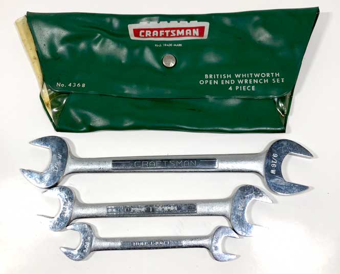

As mentioned above, Sears/Craftsman did carry Whitworth tools. They were listed in their catalogs from about 1960 to 1962. There were four DOE wrenches, four DBE wrenches and ten sockets. The set is relatively tough to complete, but not impossible. During the same time period, Sears/Craftsman also offered a less commonly known Whitworth tap and die set. I think it's more difficult to find than the wrenches and sockets. The pages depicted below are from the 1960 Craftsman hand tools catalog.
