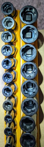

Something like this, or the wedge type, except Whitworth sizes. Does anyone make them, if so can you include a link to them?

GEARWRENCH 28 Pc. 1/4" & 3/8" Drive Bolt Biter™ Impact Extraction Socket Set - 84784 has plus and minus sizes so should be ideal.
Interesting. Does anyone here own the GW bolt biters? Can anyone confirm if the minus sizes are actually smaller sizes or just has more aggressive flutes than the non minus sizes?

After discovering GW bolt biters had minus sizes, it seems like they are supposed to be slightly smaller. I wonder if they be on hand to increase probability of successful extraction without having to weld. Something like this:
  1. Use a 12 point 10 mm chrome socket and try that, the 12 point may give you a bite
  2. Go down to next size, in this case 3/8 ". Try a 6 point chrome first.
  3. Try a 3/8 " 12 point socket
  4. Try a 10 mm extractor socket
  5. Try a 10 mm - socket from GW
  6. Try a 3/8 " extractor socket
  7. Try a 3/8 " - socket from GW
Two more attempts to extract.
Flutes look the same
I measured from the tip of the flutes.
19mm is 18.8mm
19mm- is 18.4mm
11/16" is 17.1mm
11/16"- is 16.9mm
Beautiful, thanks for confirming that they smaller in size, and not just more aggressive flutes!
