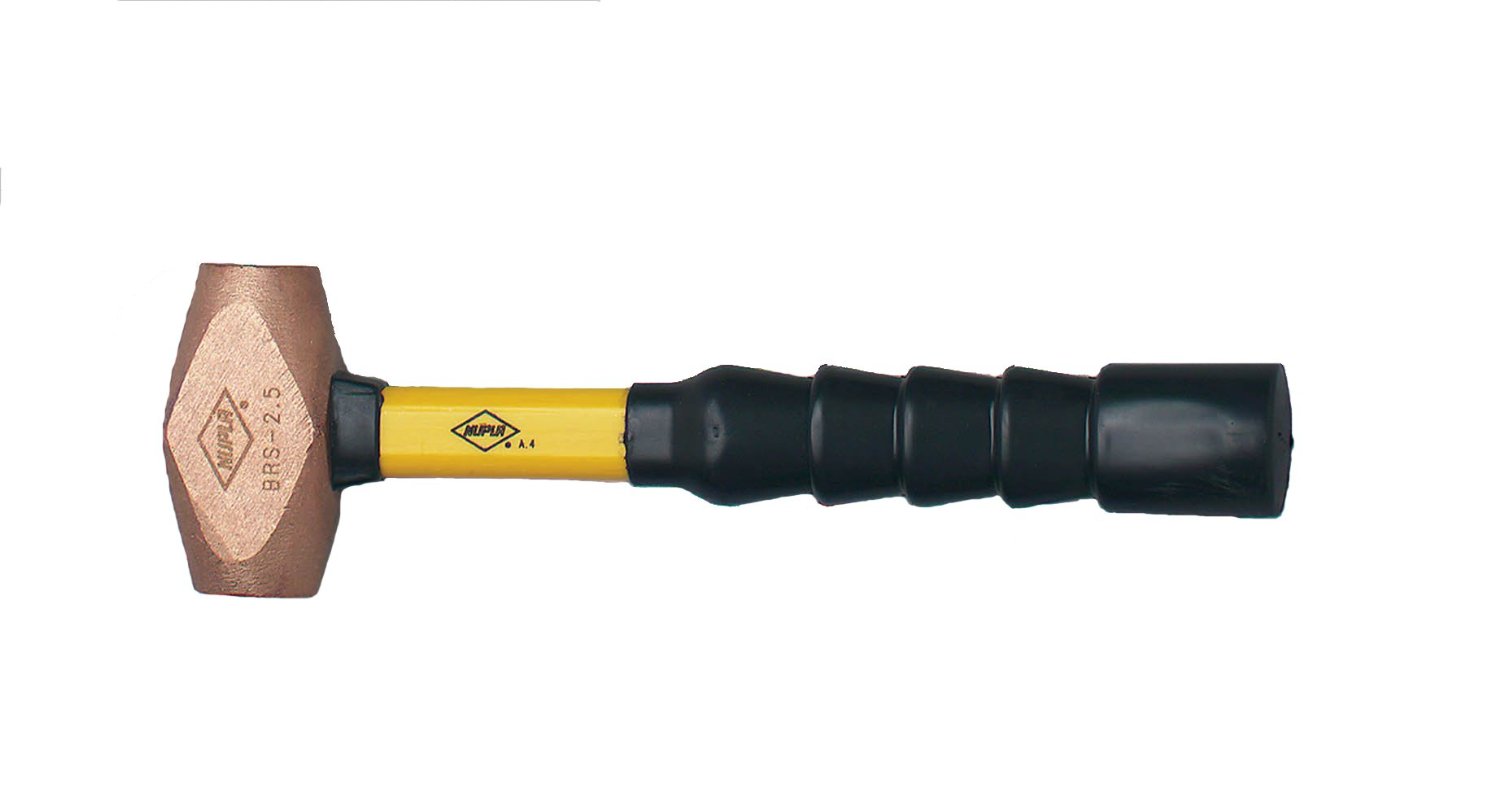

KnurledNut
Jan 28, 2011
8,175
n/a
I have that one by Nupla; I bought it a few years ago, but I think it was ~$80 then. Amazon has it for $100 now.

That's really not a bad price at all for the Snap-on lifetime guarantee on a solid brass hammer that's going to get the faces beat down to nothing and then replaced by your dealer.

I have that exact hammer. In fact, I had the orange version since the 90’s, and broke the handle about 4 years ago. My local Snap-on guy replaced it on warranty, no questions asked.
Also, that hammer is worth every penny of what they are asking for it. Bang around some open fuel areas where it’s the only choice you have and you’ll appreciate that it’s not a cheap piece of Chinese junk.

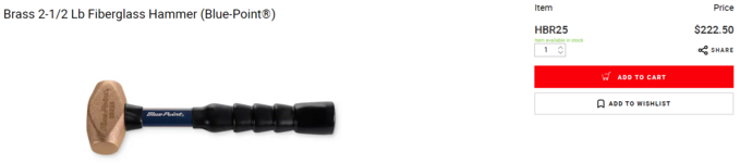

I don't give a **** if it's gold plated, only an idiot would pay $148 for that hammer.
Agree it’s expensive. Could be affected by copper prices. Then again, I think all the Snap On hammers are expensive. I probably paid this much for a set of 3 soft faced hammers.
For professional users who rely on this hammer every day (thinking maybe industrial users, not average auto techs), this may be a reasonable price for a tool they could potentially wear out every year.
I would like to have a bronze faced dead blow for my machine shop. Lixie makes them, (and also made in the USA). They are also not cheap. And the handles are no where near as nice.
Bear in mind, the one linked above is the 2lb hammer. The one pound hammer most of us would buy is $108. The lixies range in price from $50-75.

Respect. This is a 2lb bronze dead blow.
This is probably a more reasonable comparable:
Note price.
