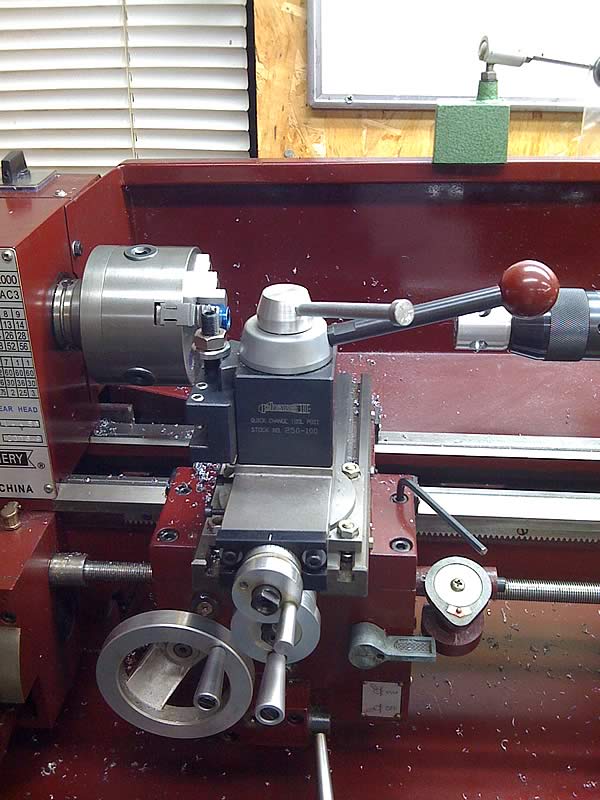

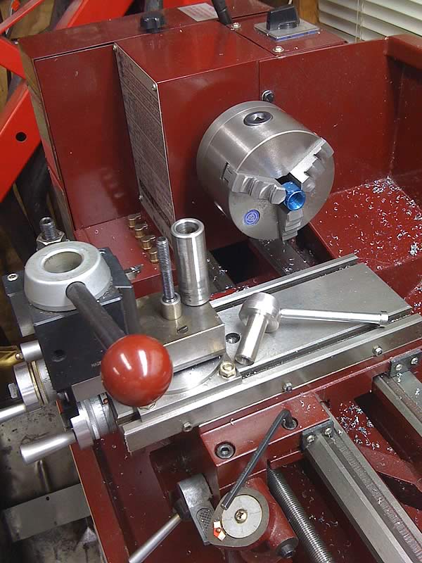

Who's got lathes?
bts
Aug 23, 2011
109
Perth. Australia
As a proper "A" size quick change toolpost for my mostly 3/4" or 1" tooling was beyond my reach I had given up on the idea. Then I came across four of these tool holders cheap on ebay two weeks ago.
Machined up a new post and remachined some of the holders to fit.
We will see how it goes.
Kevin54
MEMBER EMERITUS
Jan 12, 2005
29,341
Urbana, Ohio
That's the style of holder that comes on most of the lower to mid prices lathes, and that is what mine came with that I'm trying to get away from. You wither have to buy holder specific tools for the size, or you have to shim. You don't have any up and down adjustment. I seriously hope you didn't have to pay too much for those.
Falcon67
Jun 11, 2009
18,371
Merkel, TX
Yeah, that's what I figured.
Thanks.
It would have been nice to get some more holders for those other tools cheaper then what LMS is selling the holders for.
Hell, what am I saying, It's awesome just to have a lathe let alone to have the tooling package available and get extra accessories.
It's a good package for sure. The AXA-Phase II I have on my 9x20 is just barely short enough. In fact, some folks mill a little on the compound around the tool post mount to give a little more adjustment. My tool holders are right at the bottom of travel to be centered on the spindle. And I had -scratch that, got to- build and adapter to mount it.
tdkkart
Jun 17, 2006
6,887
Eastern Iowa
I wouldn't discount ALL 4-way toolposts based on the Chi-com pieces of ****. I've got an Enco post, from back when Enco actually made stuff(I think??), that works really well once you get past the need to shim, which really isn't a big deal once you have a handful of shim stock.
We've got a bunch of these on lathes at work, and the Clausing I picked up last fall happened to have one as well:
Even with the best of the quick change posts you give up some rigidity. This will always be the case, the further that tool is cantilevered off to the side of center the more leverage it has to flex the toolpost and compound. Not a big issue on larger lathes, but the machines us hobbie folks typically run can use all the help they can get.
There's some huge differences in the Chi-com QC posts on the market. If you're buying a Phase II set you can get by with the piston style because holders fit the post much better. Once you go to the cheaper ones, the dovetail specs are much looser and they don't fit as nicely, the wedge style posts will make up for this.

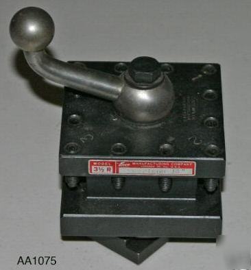

Kevin54
MEMBER EMERITUS
Jan 12, 2005
29,341
Urbana, Ohio
Kevin,
What type of holder do you recommend?
Nelson
A quick change tool holder like this one. With this style of tool post and an assortment of holders, all you have to do is raise it up or down to put it on center. If you set the stops on the holders, and you have multiple operations using different tools, you just loosen the handle, slide one off, then slide the other on. You can go from facing a part to boring the part in just a matter of seconds. Two of the better ones are Aloris and Dorian, but they are the costliest too. I bought a China brand and I should receive it this afternoon and I'll report as to what it's like. It's not the brand that I really wanted, but it's all I can afford right at the moment. Once I get a couple of doctor bills knocked out of the way, I'll pick up a better brand name, although more than likely it will be used. A new Aloris tool post with about 5 holders go for around $1500 new :scared: I'll have to keep an eye out for auctions, CL, and EvilBay for a cheaper priced one. But if you can get one for a good price, it will last a lifetime.
NASTYZEN
Jun 11, 2010
2,823
St-Colomban,Que. Canada
Thats the same one I have on my ol CVA lathe. I have shimstock en mass in a box for adjusting the tooling in it. I like that quick change style that Kevin is looking for.

Kevin54
MEMBER EMERITUS
Jan 12, 2005
29,341
Urbana, Ohio
I received my new tool post and holders yesterday, The bottom plate on the tool post had to be machined down to fit the compound on the lathe. I got that done and got it mounted. I have to say, that for $89 I'm fairly impressed for China stuff.
Occupant....the thing you mentioned about the height adjustment screws...that was the very first thing I looked at. They all appear to be straight, although they feel a little bit "grainy" from the Black Oxide finish on them. Hopefully they will smooth out after a while. But then again, probably by the time they smooth out, they'll be wore out.:lol:
I was going up to a scrap metal place today and pick up some material, but I was halfway there this morning and it was ******* and pouring rain so hard I said to heck with it and came back home. It's supposed to be half way decent tomorrow so I may run up in the morning. I need some stock just to practice with believe it or not. Yesterday was the first that I have ran a machine in almost a year and a half. :eyecrazy: And running a non-CNC is a little different due to the fact that the last 13 years I either ran two axis Bridgeports or three axis Prototraks. Cranking a handle for everything seems a little different. Especially since I can only do it with one arm. :( I felt like I walked a mile just between two handles.:spit: But I got the plate machined down to fit the lathe and everything looks good. I have a larger cutter in it and I still have a little bit of movement to move the toolholder down if need be. If I run a smaller cutter, then Ii will have all kinds of room. I was surprised though that the BXA holder is almost the size of the compound as far as the width, but it will work out fine. I have found out though that some of my tooling that was in my box is gone. I had some other items missing, but every time I get in there to find something I find something else gone.:mad: Oh well, I believe in Karma and whoever pilfered, Karma will bite them in the *** someday.
I'll snap some pics but I don't know if I can post them from this garage computer. I may have to wait and post them tonight.
