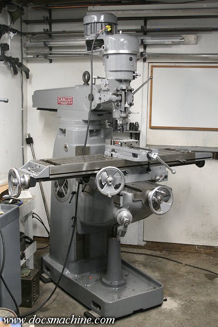

Started out with a cheap Jet mill-drill. It worked, and got me rolling, but yeah, it wasn't the best. Graduated from that to a (then) brand-new Grizzly G4027, which I've now been using nearly daily for 15 years:
About ten years ago I picked up a well-used-and-abused Nichols horizontal mill, stripped it down and nearly fully rebuilt it:
I say "nearly" because I couldn't fix the table wear at the time, but I'm currently having it ground. Once it's back, the machine will be in 100% condition again.
And then two years ago, I got this Spanish-made Anayak "Exacto" vertical, in even worse shape than the Nichols, and fully rebuilt it as well:

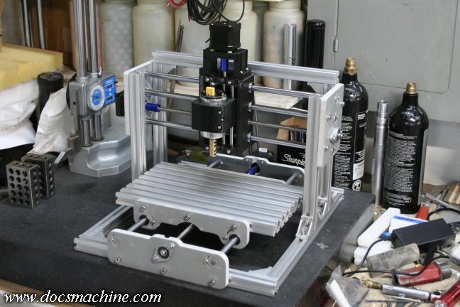

Technically I have one of these, too...
... But you can really only call it a "mill" if the only thing you know about machine tools is that several years ago a friend once tried to describe one to you over the phone. While drunk. And at a loud party. :D
