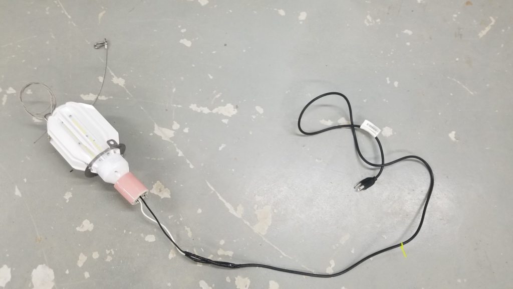

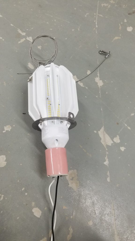

I think I have everyone beat by a few magnitudes.
165W LED putting out 20,000 lumens.
What do I win?
