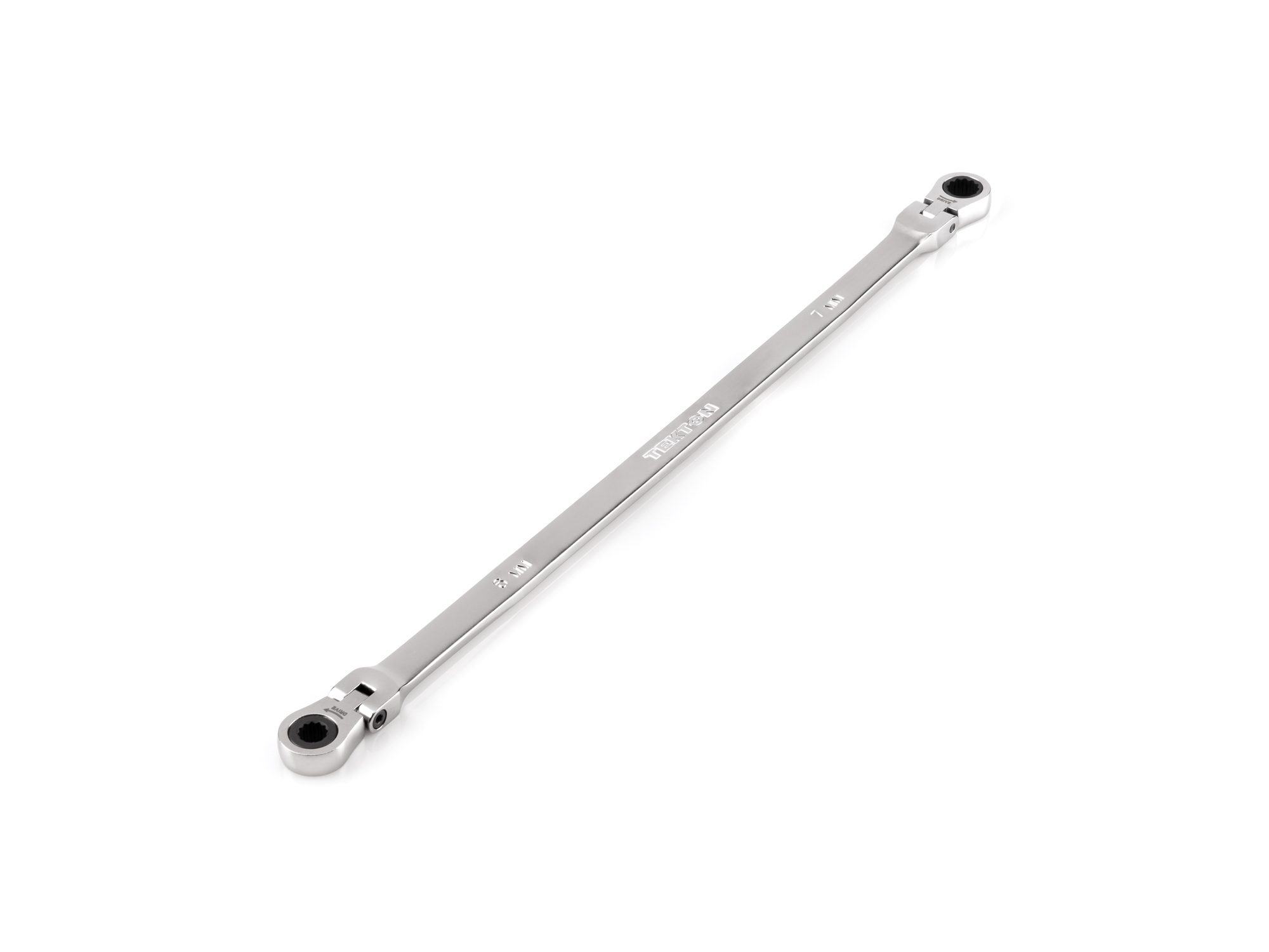

Tekton offers long flex head ratcheting wrenches without the protrusion.
I meant to compliment them. Those tekton look nice. I see gearwrench has double box end flex with no protrusion either
